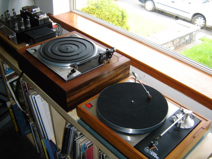

I wont be standing on it Jay............it will be a plinth for a Hi fi turntable.
Would none of the usual epoxy primers do?. Polyurethane is compatible with concrete but no great finish. Polyester Flowcoat may be compatible and it may polish up?

Have you considered JAPLAC i used it a few years ago on a slate plinth that had been damaged and the finish was very good and hardwearing once cured. If you are going for a painted finish you could apply filler then sand the surface prior to painting so you could save money and not have to be too particular with the concrete mix.
Is there a reason you're using concrete? If it's being painted it's obviously not for aesthetic reasons. If it's for it's accoustic properties (or just for weight) maybe you could cast a skin of resin (with some glass fibres like choppies so it bonds) and back-fill with concrete, that way you could use a conventional car type paint. Just a thought.
Otherwise, there is a moisture cure PU concrete sealer called G4 which is used for sealing ponds. Available in clear, black and maybe a few other colours. I have used it in the past to seal MDF which had to be spray finished to a very high quality gloss lacquer. I seem to remember it rubbed down fine with Wet & Dry (when fully cured) and formed an excellent base for 2 pack. Read the instructions carefully.... You have to second coat after something like 4 hours or leave it for a week!

Ratty: Yes it is for accoustic propertys ie. mass but it has to look the part for vanity .

International will know what paint is suitable for concrete. Ferro cement hulls will need the very same paint as will be suitable for mine. It may even be the suitable primer and then their Toplac. Thanks Simon.
Norman: I had considered leaving a slight honeycomb finish then Bondo. It may happen as you can get a great finish with filler. Testing will show what's what.
The larger deck in walnut is what it's about. That is layered birch ply with walnut veneer and weighs 42lb. Concrete version will be heavier and shaped with contour.
