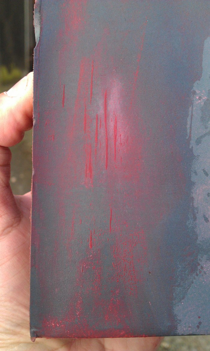

best way is to touch it with a celly cloth. if it sticks after a couple of seconds its conclusive. only 2k will withstand this so dont be going round your car with a celly cloth to find out someone has done a dodgy repair in the past as if it softens the paint, youre in trouble.
Nick
The op knows its 2k as he painted the car himself
