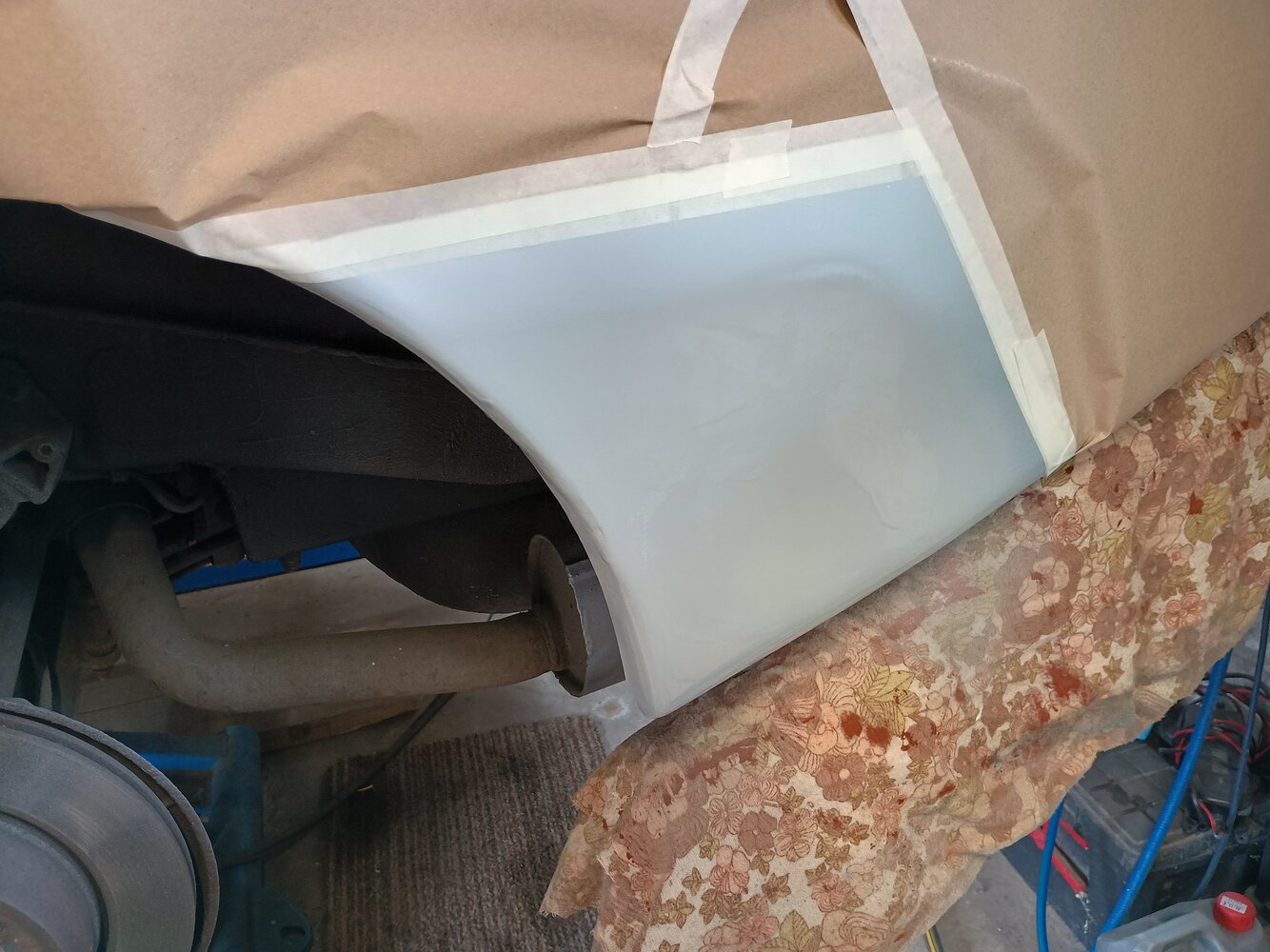

I have some lechler 29107 which is just under 4 yrs old. It's always been stored in an almost full, sealed container in my house. Admittedly unheated, but it's still in the house and won't have had shed related extremes of temperature (I live near the sea- frost Very rare and snow almost unheard of).
It's got fast hardener and I sprayed some end of last week and it's sure taking its time to harden up. It's sanding fine, even up to 800 dry but in thicker film areas it's still marking easily with a finger nail. The paint needed a good stirring but then seemed fine and the hardener looked perfect without visual signs of deterioration.
Tbh I seem to remember it taking a while to hard when applied thickly even when it was new so maybe after another few days it'll be ok.
Firstly, what are people's experience with elderly 2k paints? I saw a post from @Dcal where he said he'd used old paint and it was ok. What brands were they? Storage conditions etc and how old? Any more info would be useful
I feel this thread could be useful for people as lots of us struggle to use paints within the official shelf life.
Obviously mixing a test batch is sensible/ mandatory but then some of us love to try it on and risk sanding a load of gunge hahaha.
I did read a tip on the southern polyurethanes forum which was to shoot some welding gas into the paint tins before sealing. With argon being heavier than air it should purge the tins and isolate the contents from air which according to those guys massively extends shelf life as there's a lot less to react with. Would it be worth making a Sticky with this info?
