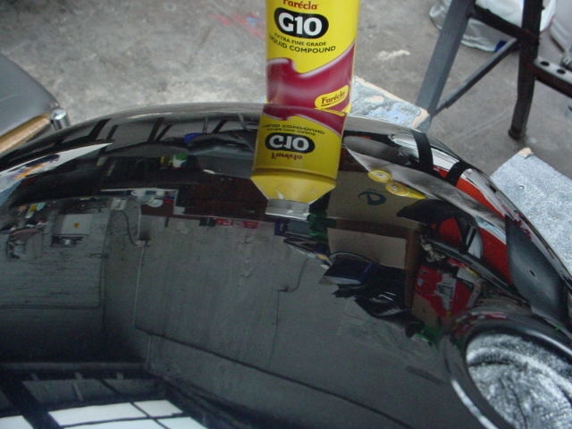

I've finally got my beetle in paint,base and 3 coats of ms 2k clear(max meyer).Now I'm generally really pleased with the finish but I have a few runs and some dust in the paint.Orange peel isn't too bad,though I could do with loosing a little in places.
I've read previous posts regarding polishing but I'm not after a show finish,more of a production finish so I don't want to flat back all over with multigrades of wet and dry,then polish several times.I don't want to loose the nice glossy look I've achieved.
How would a production shop denib and polish?
I've got 1500 wet and dry,a polisher with black,orange and white pads, and farecla g6 and total.The inside I flated back with the 1500 then used the total with a 3 inch polisher, it looks good but possibly has lost a little of the glossiness.Heres a pic of what I have now.

can be removed by the above method of applying a little body filler or use a run razor then a block with wet/dry
