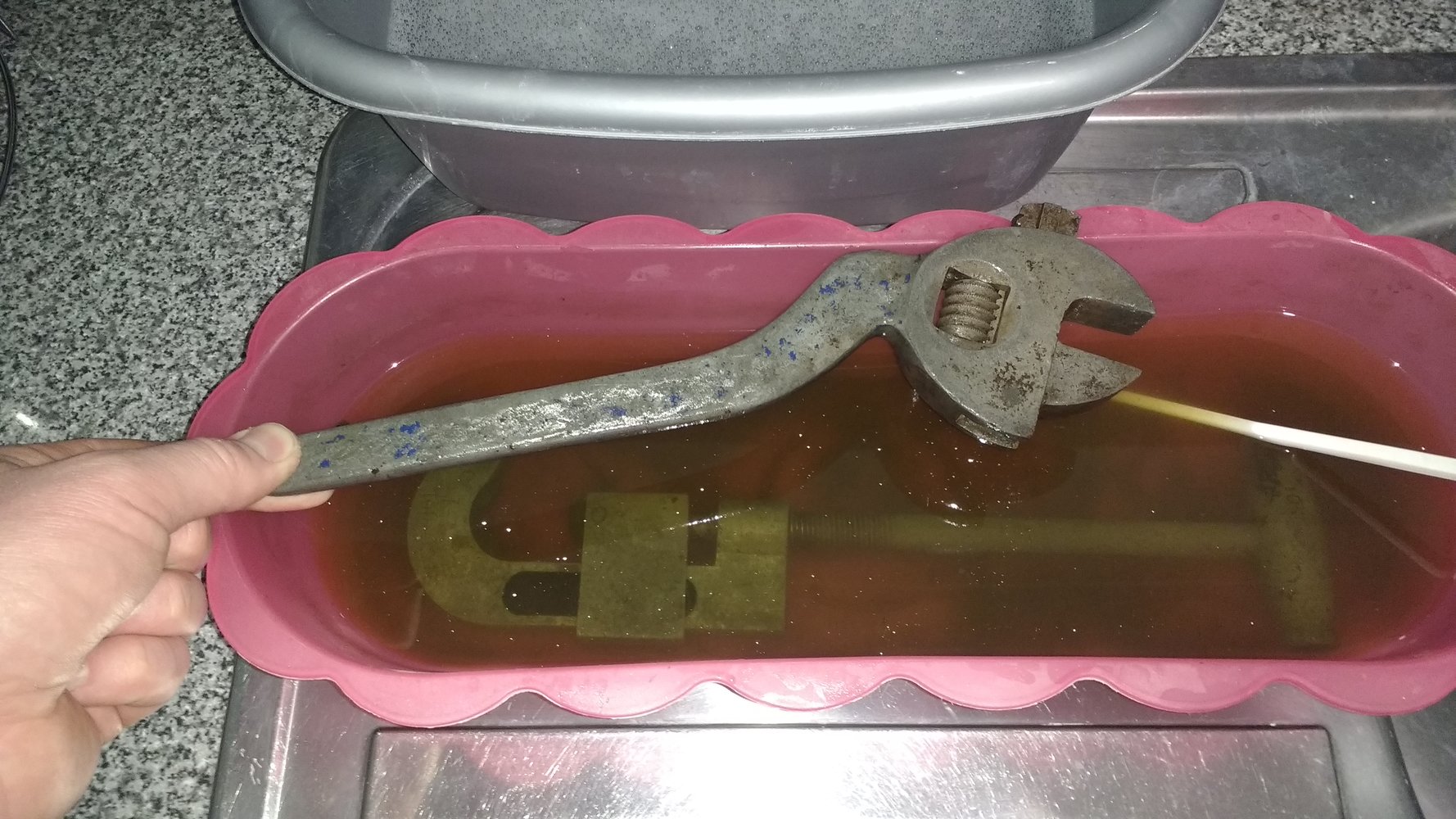

After citric acid derusting I'll have these tools to paint:
I was thinking:
- wash in hot soapy water
- dry with the hot air gun
- 50% phosphoric acid wash and let air dry
- mask the sliding surfaces, thumb wheels etc
- etch prime from a rattle can
- top coat with whatever old car paint is lying around.
- oil the sliding bits
