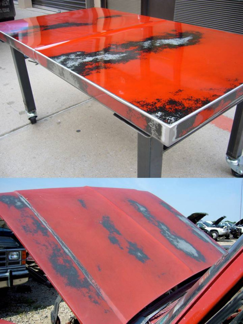

That table IS the bonnet.
there is a look on the hotrod scene in the US where they find old patinaed trucks and just shoot clear over them.
Its been done on Gas Monkey before.
It you want this from scratch you'll need to build up the layers of paint different colours and different ticknesses. Then rub away the layers in places to create the patina. You'll need to spray salt water over the bare areas if you want rusty patches. Once you are happy with the effect you clear coat.
