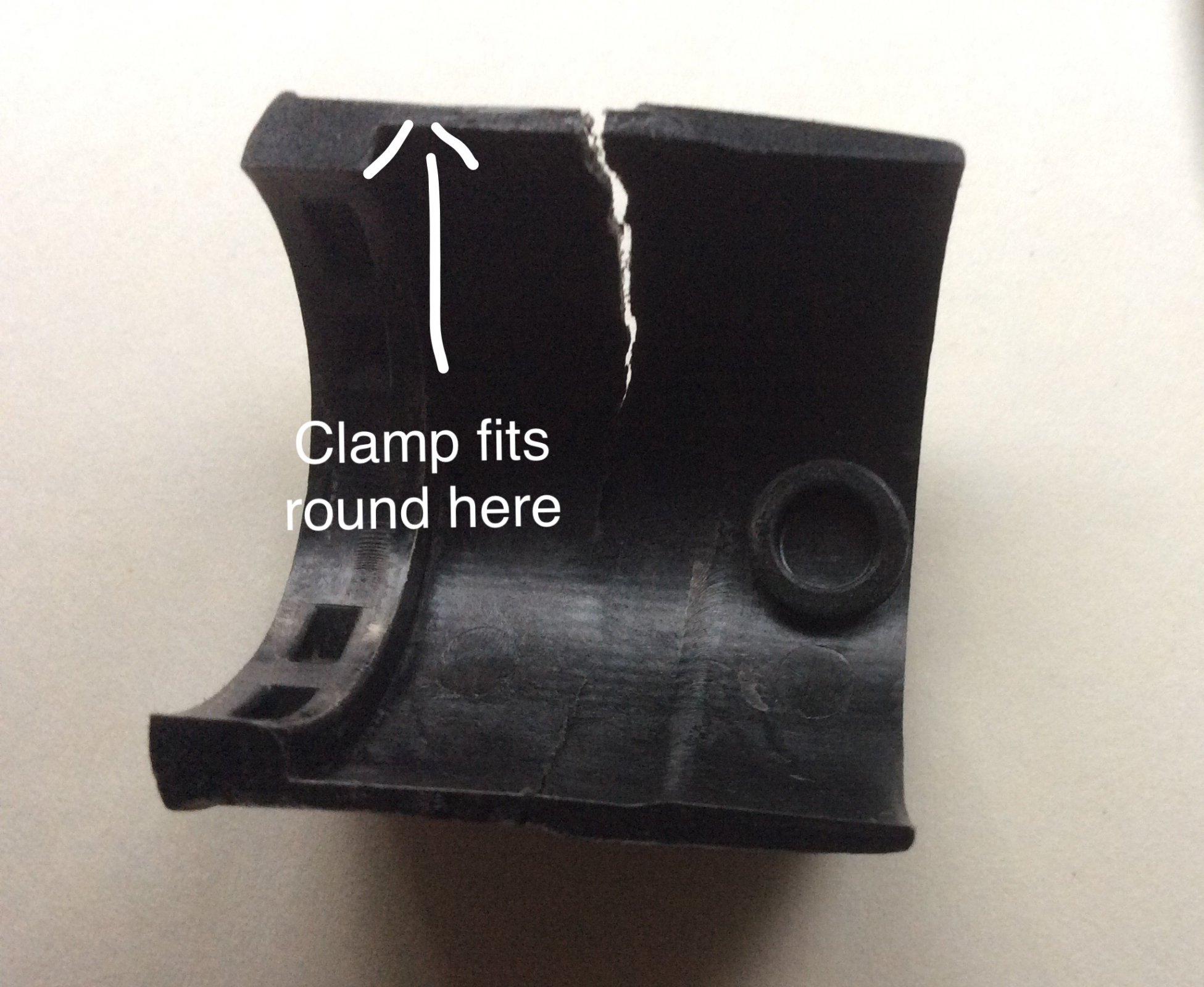

They were sold as Ultimate stands & made in the good old US of A. They've only been used a few times but the clamp (two piece clamped collet type) that holds the stand at the chosen height has broken completely on one & not far off on the other.
I can get replacement spares from America, although the stands are sold in the UK nobody it seems sells the spares. Also I think they've been made out of the wrong type of "hard" plastic which has contributed to their failure, so I'm disinclined to buy new spares as they will probably go the same way equally quickly.
I'm contemplating turning some replacements out of something like Nylon (open to better suggestions) but the problem would be forming the "peg" (NB it doesn't have to be hollow) which juts out from the bottom of the the collets to hold onto the lower part of the stand (see photo). Any thoughts on it could added I only have a lathe to hand.
Had my own thought if I purchased some Nylon rod & drilled a tight hole in the collet, then turned the rod in a drill, would it generate enough heat by friction to weld both together? Would this work?
