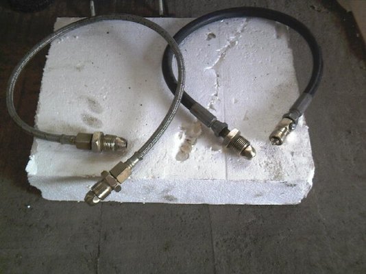

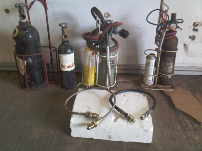

This statement is untrue and is potentially very dangerous - please delete that post Brightspark.
SOME hydraulic hose will operate at higher pressures, but NOT MANY. A good number of single-wire and two-wire hydraulic hoses are rated at less than 150 bar when new, and if used for decanting will fail.
We manufacture hydraulic hose assemblies, and do not have the required equipment for 700 bar - not many manufacturers do.
reid suply industrial products do the hose 10.000psi working pressure not that i kept thread going .thought it was dead and buried . the kits are available though from portaflame £50 so i wouldnt think they would still sell them publicly if it wasnt safe. i can see your concern best thing is delete the whole thread ive got the information i wanted
