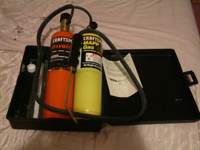

Wallace Member Messages 7,808 Location Staines, Middlesex, England. Nov 13, 2012 #4 Do you have Oxy-Mapp like this or just Mapp Mike OXY_MAPP.jpg 51.8 KB · Views: 284
J jordan1 Member Messages 2,045 Location Yorkshire England Nov 13, 2012 #5 Wallace said: Do you have Oxy-Mapp like this or just Mapp Mike Click to expand... Just Mapp, Surefire II, I think.
Wallace Member Messages 7,808 Location Staines, Middlesex, England. Nov 13, 2012 #6 Would a Portapak be too big? Running costs would be cheaper than the OxyTurbo 110 set. Mike
