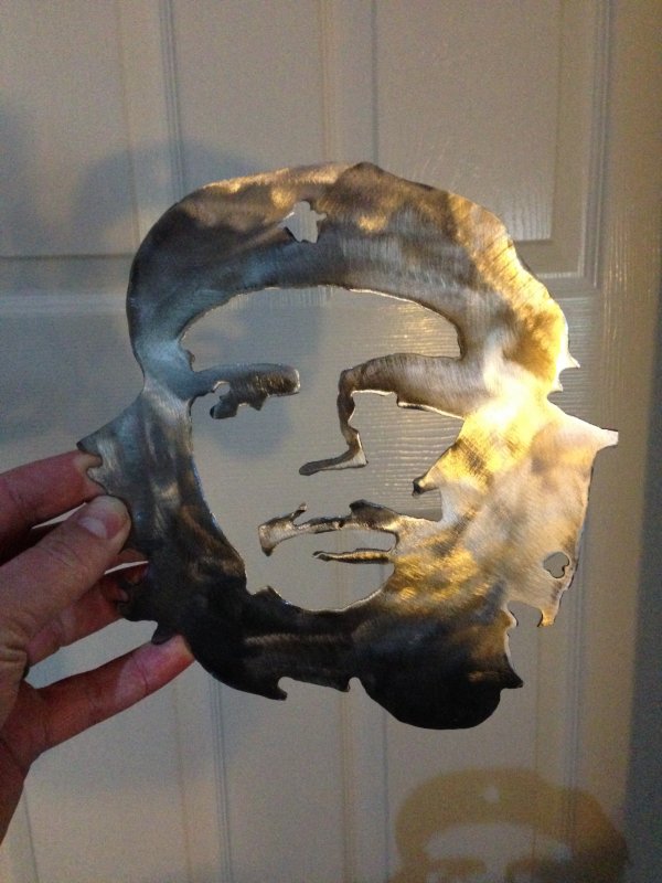

Im getting sick of cutting 4mm sheet by hand now, hand is aching from the hacksaw. And the jigsaw just takes ages.
Straight lines are fine with a slitting disc but curves and circles are a pain.
I mainly do this on a diy basis so don't want to spend a fortune which is why im asking this.
When initial purchase cost and consumable are taken into account, what works out the best value for money?
Oxy gear is cheap to buy but then there is the cost of refill and maybe bottle hire (plus the space to store it) where as plasma is more expensive to buy but then the consumables seem a fair price.
I know a plasma requires a compressor and I have one of the 25l aldi specials but not sure it would be enough for the job.
Its not something im going to get right now, just planning ahead little.
Your thoughts please, and not the dirty ones!
