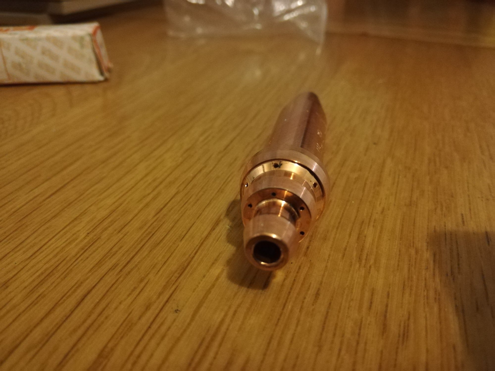

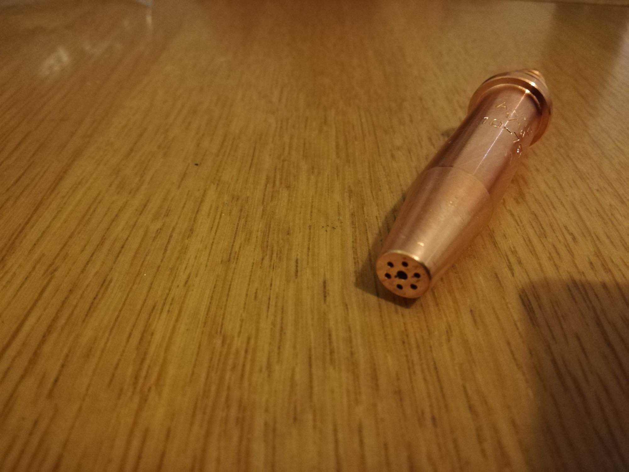

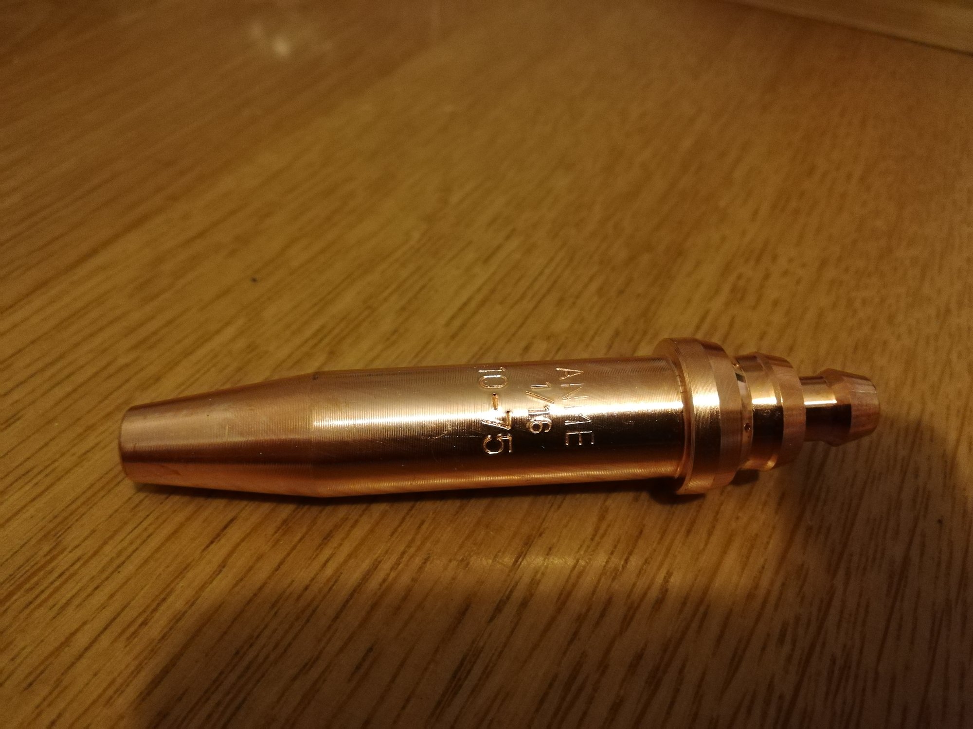

pondy Member Messages 1,627 Location chedburgh, suffolk. uk Nov 3, 2018 #1 Can someone please confirm if this nozzle is for acetylene? I do not know the difference between propane and acetylene nozzles.
WorkshopChris Member Messages 5,049 Location South East Essex Nov 3, 2018 #2 Yes, acetylene the propane cutting nozzles are normally 2 part, inner and outer.
Paul. Moderator Messages 7,047 Location Northampton. UK Nov 3, 2018 #3 Yep, ANM means acetylene nozzle mixing, propane nozzles are a 2 part item, completely different and will be marked PNM
