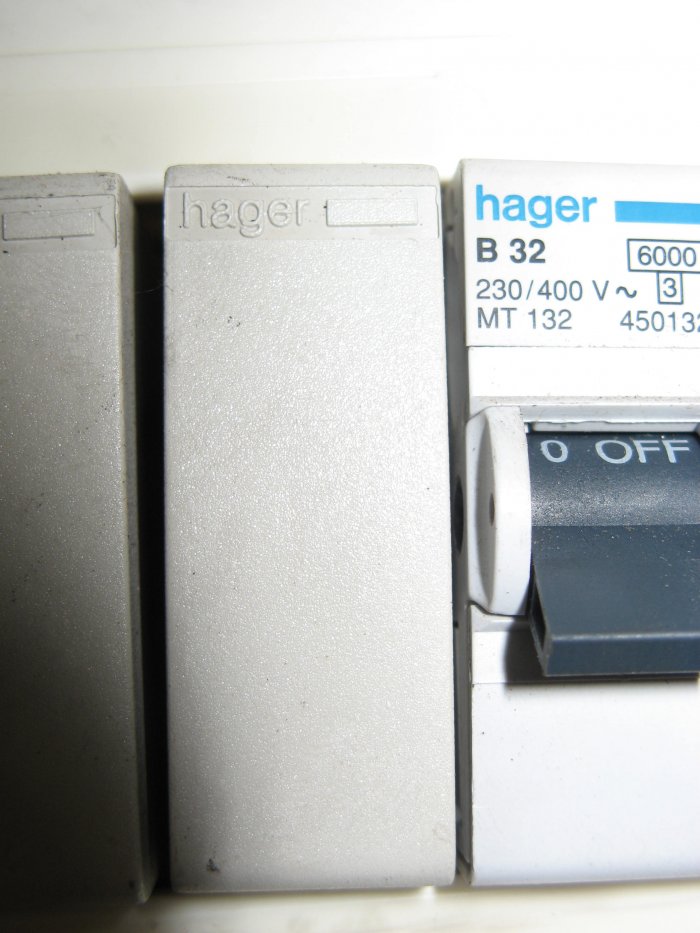

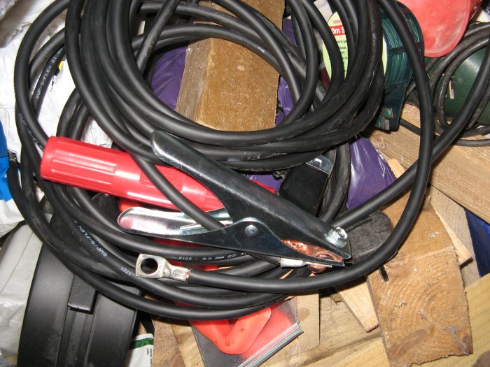

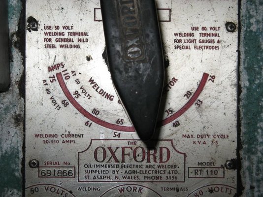

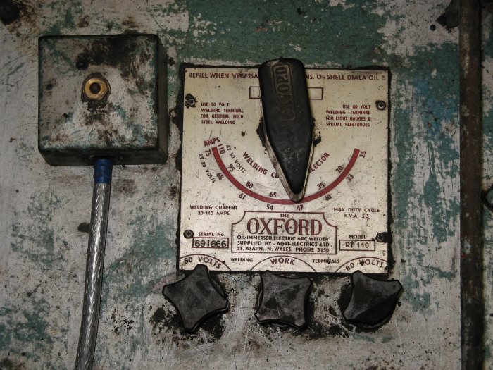

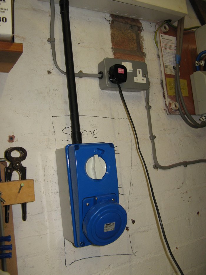

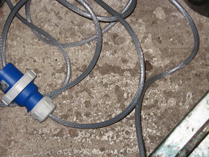

I was going to buy a Clarke MIG 135 TE, but a friend of mine offered me his Oxford Oil Cooled welder. I probably paid over the odds for it, given that the cables had no protection and I've had to replace them with nice new ones, but better to do that than receive a 'shock'! I have also rewired it with a 32 amp plug and armoured cable. I have had a 32amp switch socket installed by an electrician in the garage with a 32 amp fuse.
So, last weekend I prepared myself for a bit of a practise. I grinded some steel back to its shiny glory, switched on the welder and........ trip went the fuse. I re-set everything and re-started and trip it went again. I turned the amps down to about 55 and re-started and it hummed into action, but think I was too nervous to strike an arc thinking it was going to trip so gave up and packed away.
I've taken some photos of my set up and will upload later, but wondered whether putting in a C32 or D32 MCB would solve the issue? The electrician says he installed the 32 amp socket with 6mm cable and the distance from the socket to the fuse box is no more than 18 inches.
Can anyone help please?
