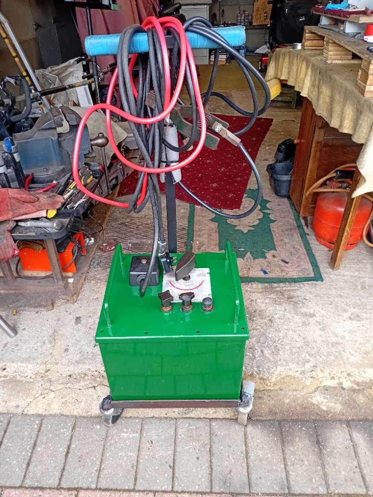

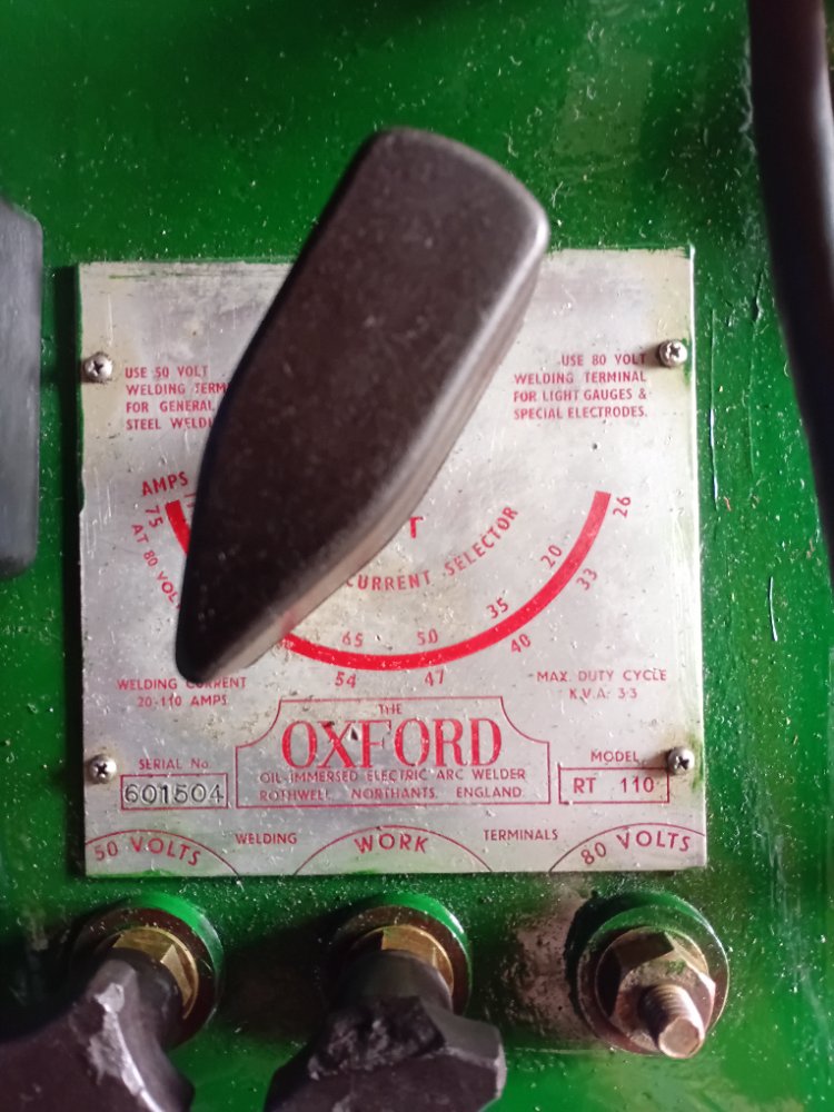

Ok I have managed to weld up the bottom of my machine i tested it for leakage by putting a gallon of old oil in the case and all seems good now bone dry, so I'm ready to by the correct transformer oil the only thing I need to know is how much oil to fill anyone know as I don't seem to find this information. Thankyou.
might re paint it and might not
