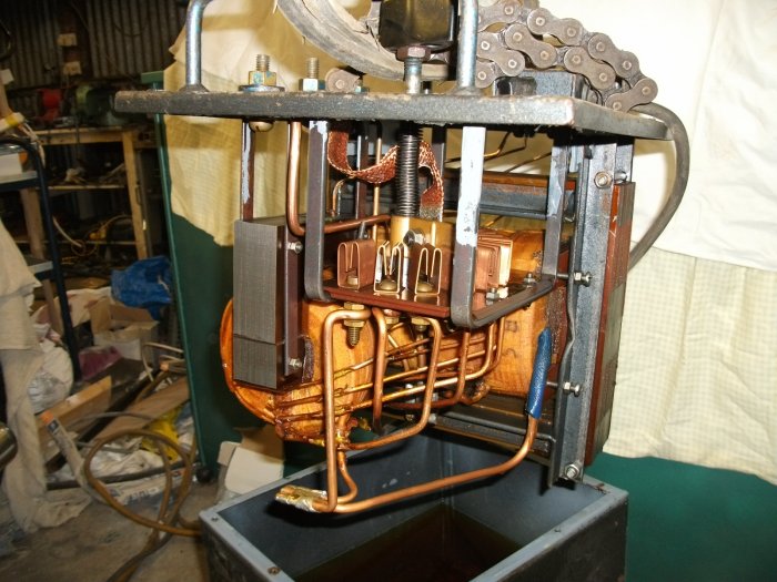

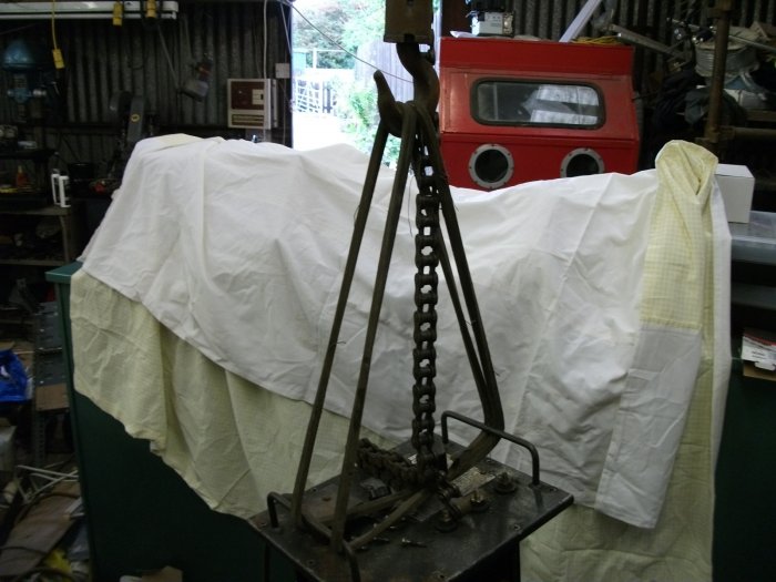

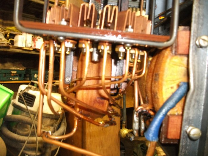

i might have a look in mine as its 35 years old and never been touched and used regular .il report back on the findings when i do .pcbs were banned 30 years agoWhat I would do if I bought one of these is to take the bolts out the top and lift the whole lot out,dump the oil and give the tank a clean out.Refill with new transformer oil.
Reason for that is,most of the ones I have seen burnt out were due to a lot of water in the oil,caused by condensation usually.Then they will last another hundred years.
All oil filled welders should have the oil checked occasionally.
