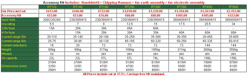

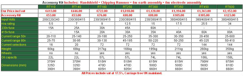

I have a Oxford 300amp arc welder currently set up on 415v, I want to try it at home on 230v the terminal block shows 230v, I think it should be live to 230 neutral to 0 and earth to E does that seem right?, The main plate states it is 230v 380v and 415v, I know i cannot test it on full amps just want to try it.
