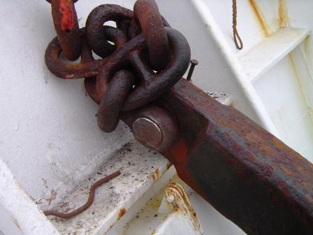

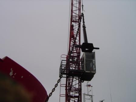

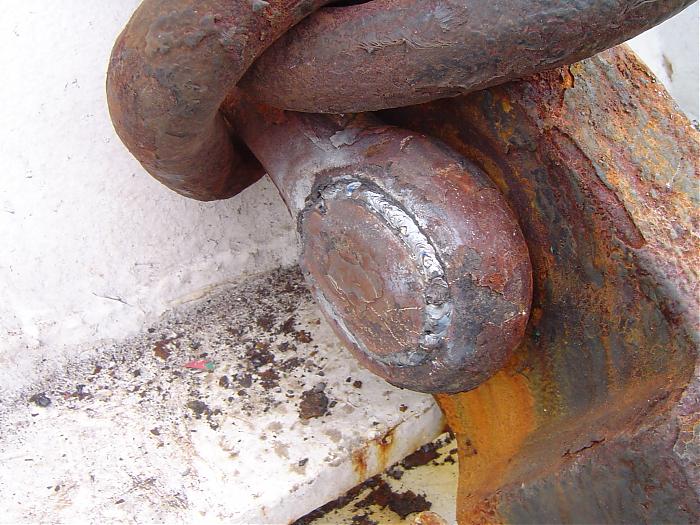

Just a quick fix this one, tho' there's a patch to put on the bow when she' returns from Finland... the anchor had come detached simply down to a striped D shackle, and droped in the drink, but we managed to retreve and place aboard for welding (in the end)...
The salt and the corostion, makes for a terable weld, I now use 6010s to acheve pen, overwise iv found all the weld sits on the surface.....
It was a 2hrs, geting the anchor, and 20mins welding....
