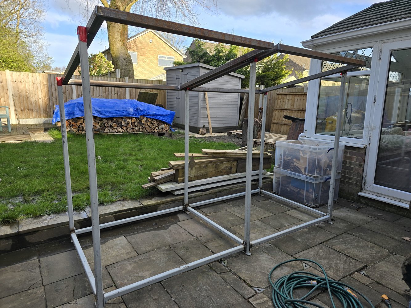

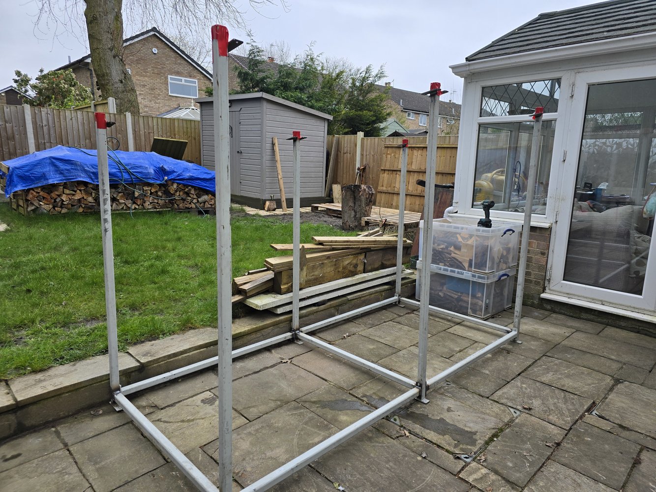

Probably won't be much of a thread but thought I'd shive it up anyways,
Making a steel logs store from material left over from jobs and over ordered etc, will need to buy the mesh for base and sides but hopefully that will be it of and rubber for the roof.
Plan is to have a gutter running along the back edge, so.only having g a 70mm over hang, front will have a 150mm over hang,
Sides will be weld mesh either 1" or 2" undecided yet, with some scaffold netting to try keep the heavier rain off but can be removed in summer.
Back will just be weldmesh as it's about 300mm from a fence and wind doesn't blow that direction.
Front I'm undecided if to make some doors using mesh etc.
Made the base and sides from 40x40x 6 box, roof squares will be made from 50x50x3 box then covered in marine ply and rubber.
This isn't it's final location it will be against the fence behind next to the shed. Made it so can be disassembled should I ever need to and keeping it as 2 separate stores but bolted together if that makes sense
