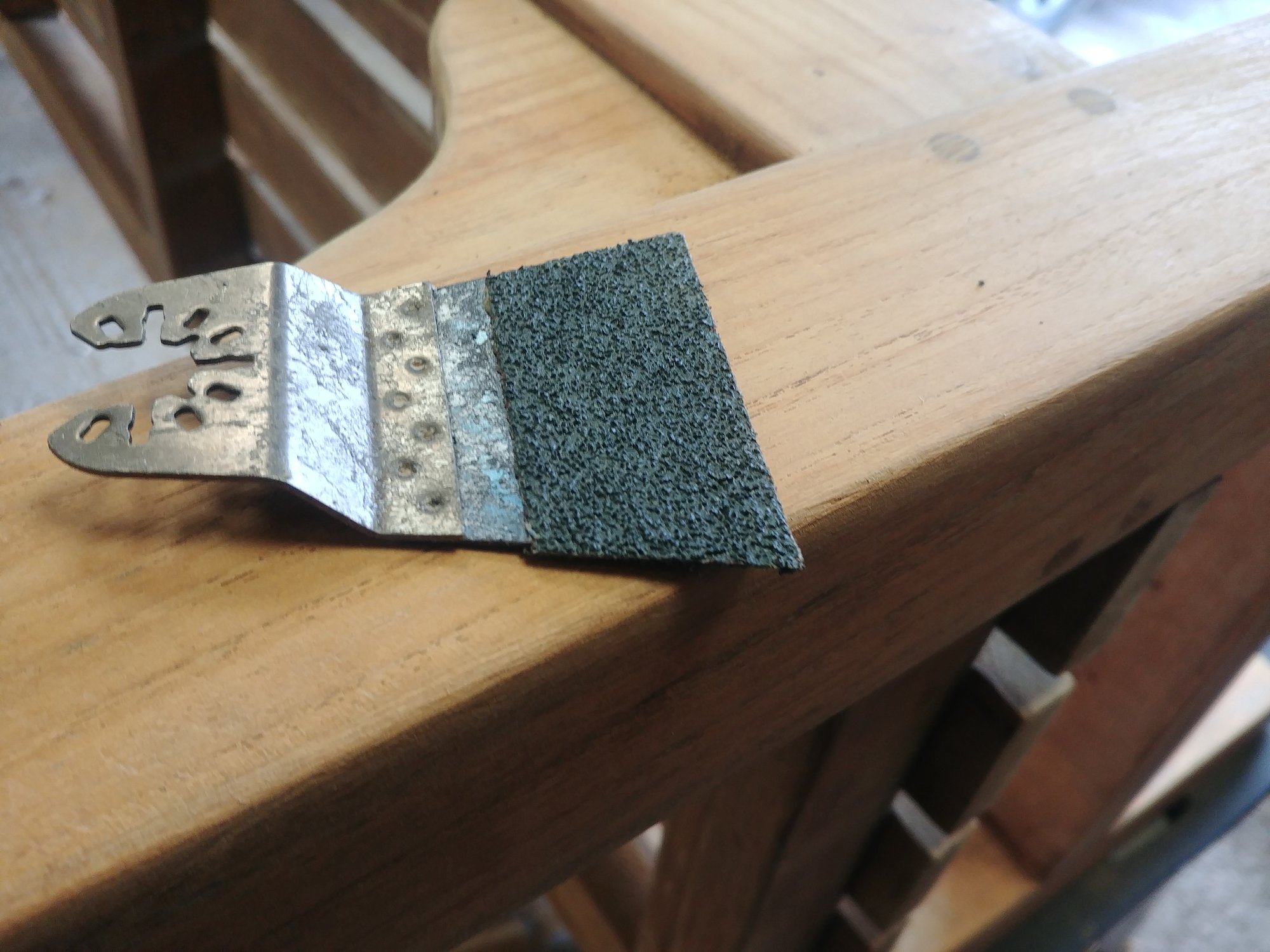

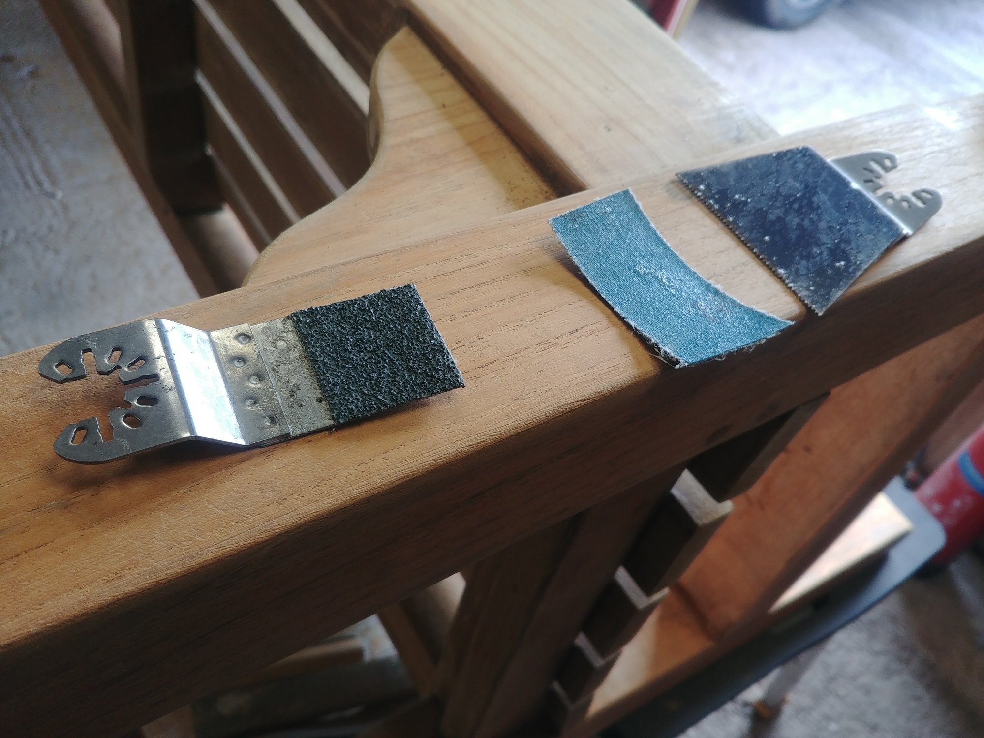

Ater using the 18v Dewalt oscillating multi tool today i was annoyed how badly the Velcro sanding pads failed to stay in place and i was going through them very fast as i was trying to get Ronseal water based varnish off am oak bench that had also been waxed and then left to go minging, I have a box of old saw blades to suit multi tools that are well worn so i used carpet glue to stick emery cloth on a roll on both sides some of the old saw blades, I used heat to cure them and clamped them in the vice for 10 minutes and i have to say with the coarse emery i smashed through the old varnish and wax, it saved quite a lot of time and wasted sanding pads and now i have a good reason to keep old multi tool blades.
