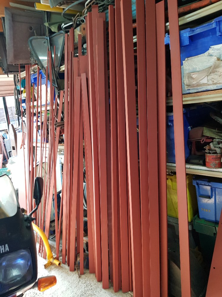

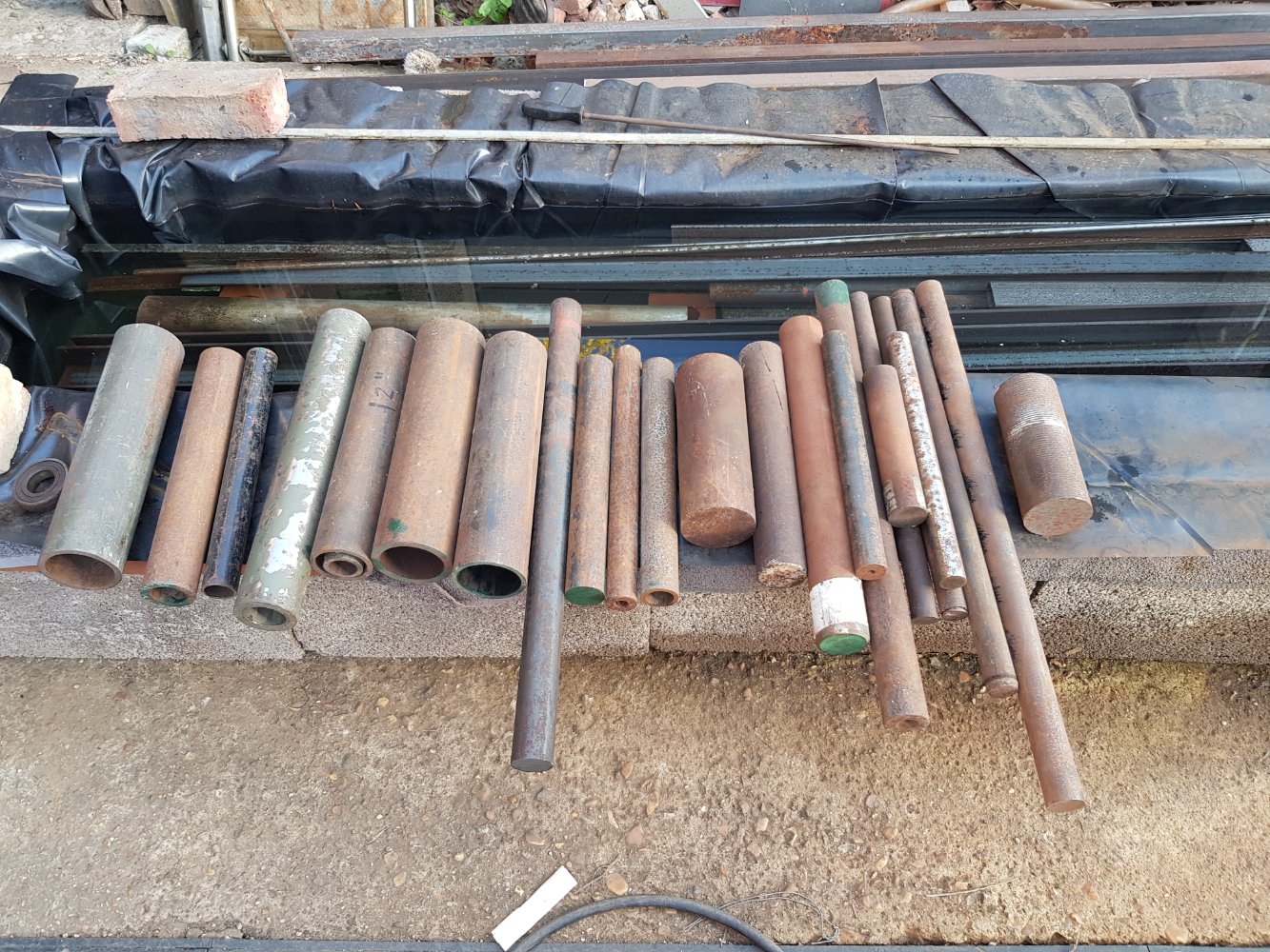

Had a week off last week and decided to have a sort out of the steel rack and discovered that quite a lot of it is starting to go quite rusty saveable but if i leave it not going to improve

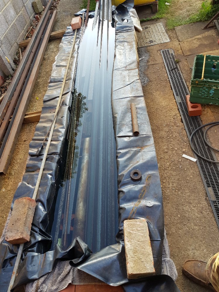

So a quick look round the garden and found enough concrete blocks to make a 10ft trough and £10 of black 1200 membrane from screwfix and an order of Citrix acid from Amazon i had this the next day!

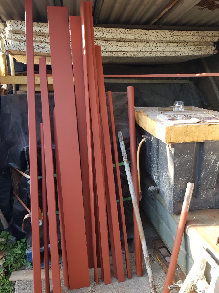

so far about a ton of metal through it and painted , might even get efficient and actually record what i have
Trouble is im looking at everything now and might as well do all my stock that is starting to turn...
Some of the stuff for turning I'll probably grease or ACF50 but i guess theres no harm in primering it to be chucked in the lathe
