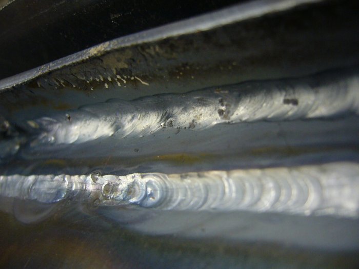

Hi All,
With more knowledge here than you can shake a stinky stick at could I have some opinions on my practice pieces please.....
I think they look ok, but worried that there was too much heat or not enough penetration. Lower weld (left) is a lap weld and the other a 90.
2.5mm steel using 2.4 Lanthanated (not that well pointed though, until the diamond wheel comes) and 1.6 filler (don't have 2.4mm) on the 90, no filler on the lap weld. Using pure argon at about 8lpm
Seemed to take about 65 amp which seems higher than the Ceriated or the 1.6mm.
Cheers all
