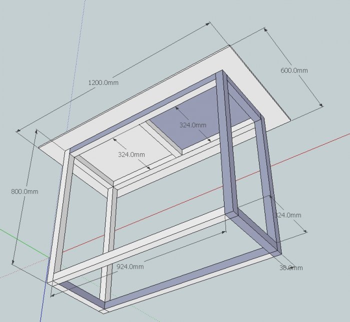

Gday guys, been playing with the new welder and getting over working on the floor. Once im more confident in my welds ill be making a table.Been playing on google sketch up and ive made my design. Looking of any input you think may improve the table be it extra supports will it hold up etc etc
1. I want a table that is mobile ( have have four 100kg each capacity wheels not drawn in the picture)
2. I want to be able to walk around it so no permanent fixtures.
3. It would hold perhaps 150kg item once or twice in its life time.
Materials are:
Top 1200mmx600mmx10mm weighing in at 57kg
and about 8.5meters worth of 38mmx38mmx3mm RHS
So the total weight of the table will be around 130kg
