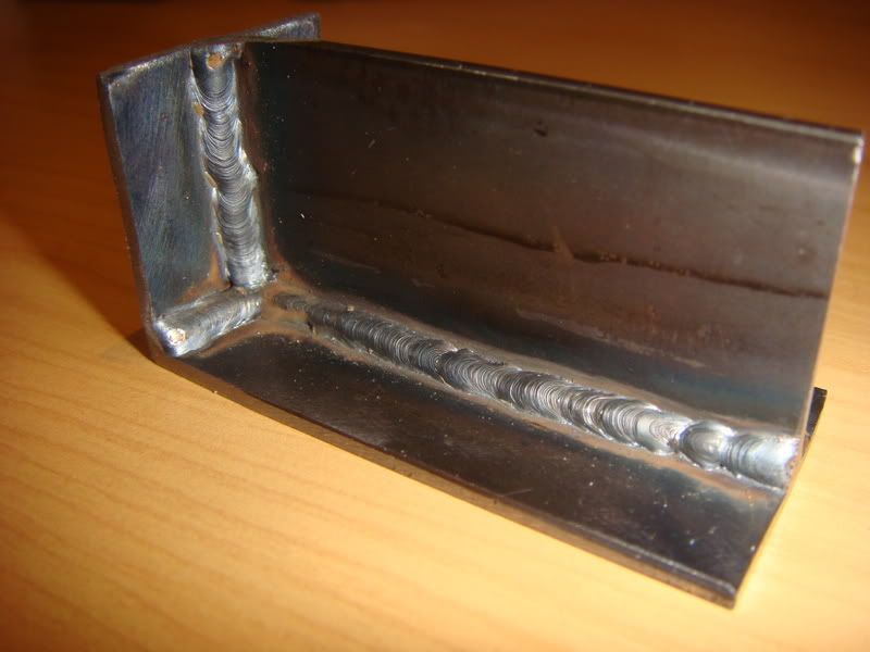

You look to be on the right track, my only comments would be the weld needs to sit a lot flatter, either turn the volts up or the wire feed speed down.
The leg length of the weld only needs to be around the same as the material thickness so try and get used to travelling a bit quicker and try to avoid stopping/starting in a corner, apart from that looking good
