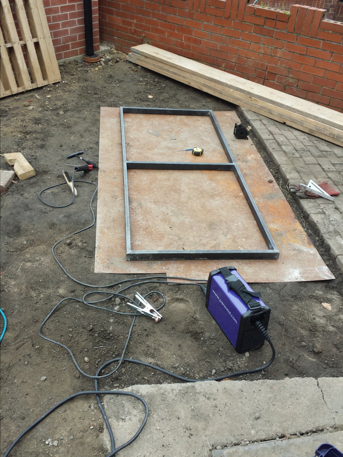

Another update is the welding table which I've made over the last week or so with some spare time from the family.
It measures 1800mm x 800mm with a 6mm top.
All built out of 40x40x3mm box with 1mm sheet shelves.
I've also mounted the sockets under the table so that the cables aren't running across the top, that's a massive headache for me.
