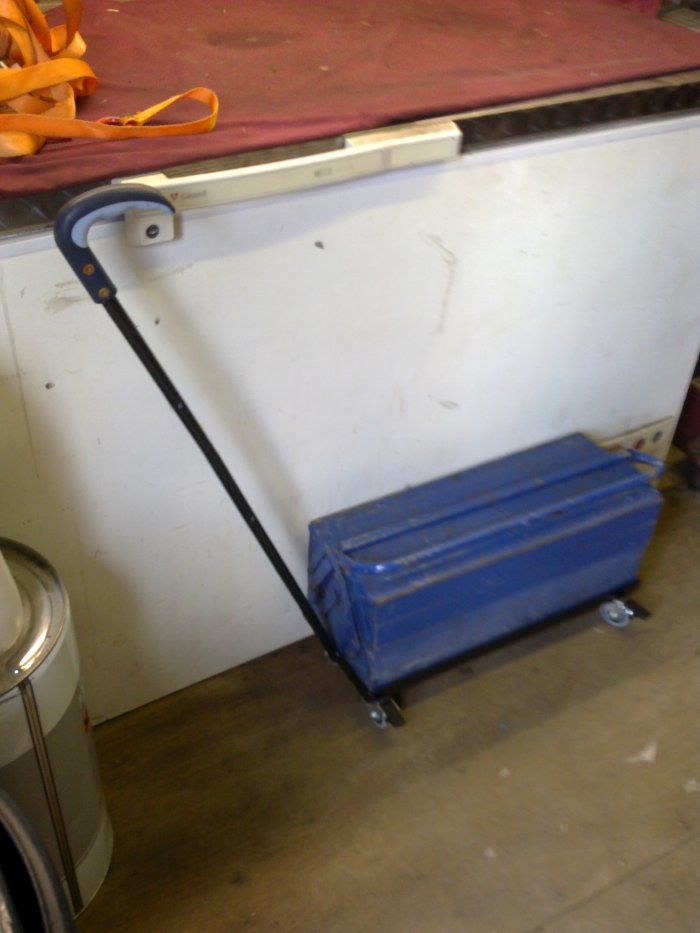

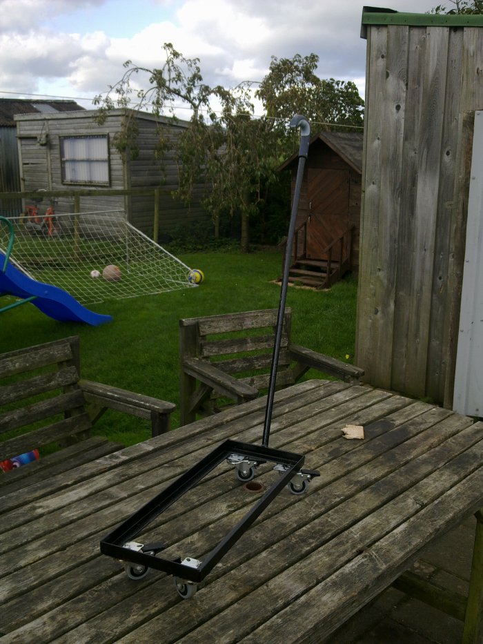

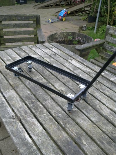

T Trev3635 Member Messages 59 Feb 18, 2012 #1 This is my toolbox trolley. Very simple but very handy. The handle is from a childs buggy i had lying around.
Robotstar5 Casanunda Staff member Messages 23,190 Location Birmingham Feb 18, 2012 #2 Nice first job we used to make something similar when I worked at Longbridge as jobs could be literally hundreds of metres away . If you make another, put fixed castors on the non handle end and find/make some sort of flexible coupling where the handle joins the frame.
