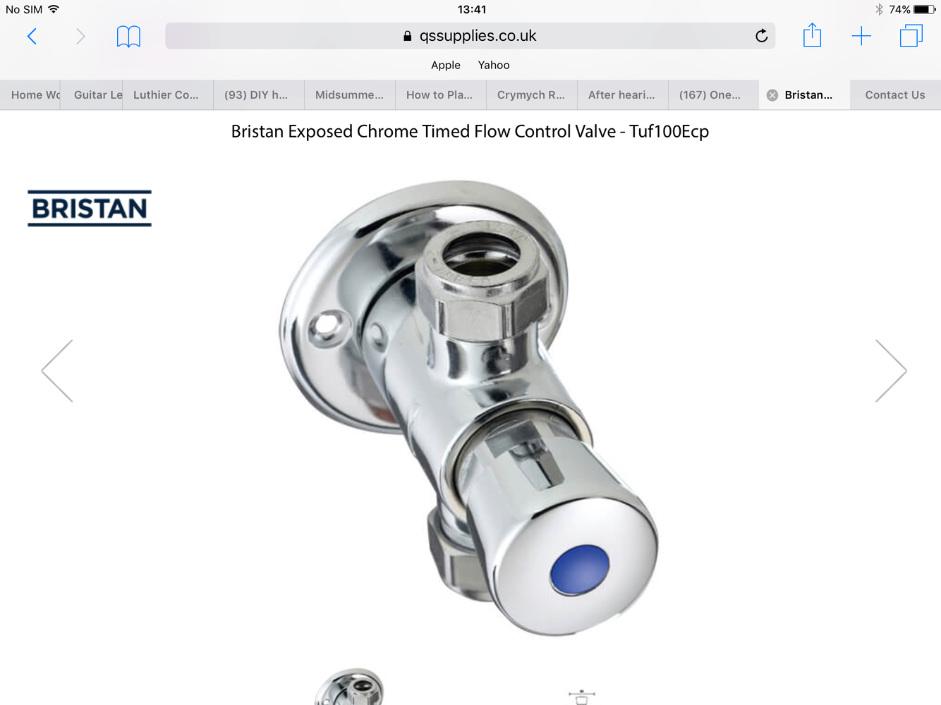

Thanks, found him - best they do is replacement valve @46.00. I need 15...Try this on Shower Doctor - https://www.showerdoc.com/identify-my-shower

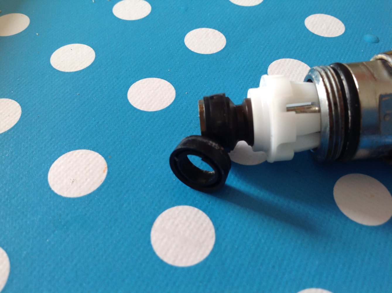

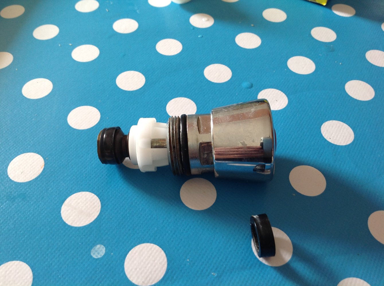

Just the valve , somewhere out the way will be a blender , mixing the hot and cold to a preset temperature. It is purely a timed valve .Well here we are, they are Bristan surface mounted taps. Just spoke to them - uk supplier, waste of time. They hold no spares at all...
So I'm going to measure up and buy generic - 20 of them. Its warm but not hot water - do I need neoprene or anything fancy?

1 Years guarantee, easy to strip, o rings and seals are cheap, but this is 2022... They are £100 each, so not cheap, even with discount I was looking at £1000. The shower doc did have cartridges for £46.50, so that would be the next option.Just the valve , somewhere out the way will be a blender , mixing the hot and cold to a preset temperature. It is purely a timed valve .
Best not to buy cheap or you’ll be buying them again soon . Bristan is a good brand .
Probably find spares are sparse as to be honest , they aren’t expensive , and the time taken to repair / service out parts is the same as just switching over the whole unit .
Yes, waste of time - no spares available.Have you contacted Bristan directly?
