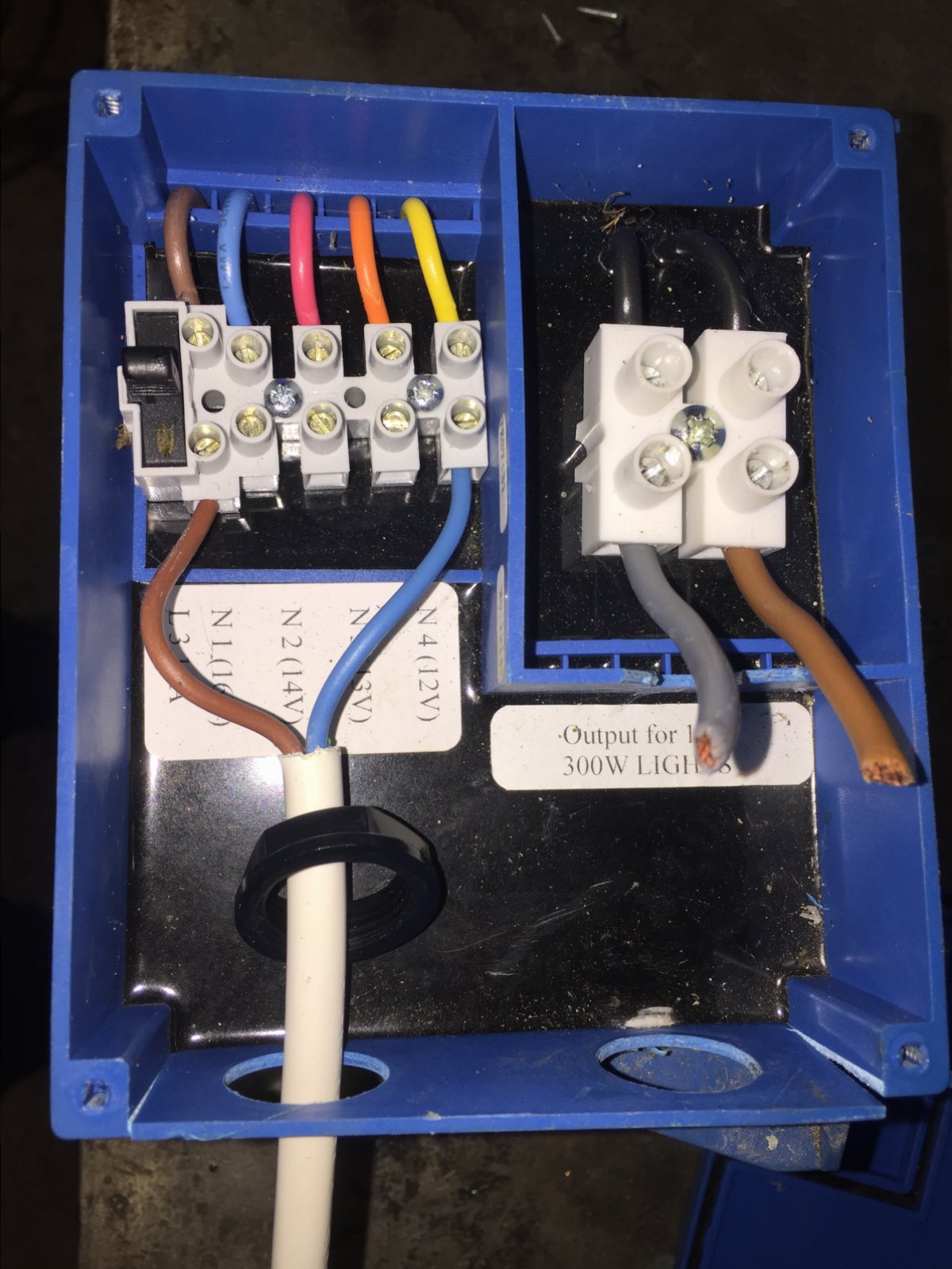

the L is live and the 4 Ns are to change the output. its set for 12V
the larger pair are the output as it states. They'll be 12V AC with a Max of 25A
I'm guessing you want 12V DC. You will need a bridge rectifier and quite a large capacitor for that. Might be easier and cheaper to use an old PC power supply, that would be regulated as well.

If you find a upmarket cb psu, or a cheap lab psu, they will have a automatic crowbar, that is if you hang a load on them with a short or excessive draw, a protection circuit will kick in that wont require a manual reset once removed. Lab psu's let you adjust the limit the crowbar comes in, so say you expect a device to take 2amp and it takes 8 and starts smoking on a 10amp psu, you can set the current limit to come in at 2.5amp and note its drawing too much current often without creating enough heat to destroy it, also bump volts up to 13.8v if variable voltage to see how something responds to alternator charging voltage instead of 12v. Also see how it behaves with low voltage, Ive seen ecu's reset when under voltaged, and during cranking the system voltage in a car is reduced as you know.
Depends how much you will use it and what for and amps required if you can justify a cheaper lab psu though. This is the sort of thing I mean, but Ive seen them cheaper than this. http://www.ebay.co.uk/itm/NEW-DIGIT...00W-CV-CC-LAB-USE-HAM-CB-RADIO-/282176181180?
Thanks mate, it's only for testing things like wiring looms, wiper motors, fuel pumps, etc etc
Depending how big a load you're planning to put on it. old computer PSUs are a cheap way to get a 12V supply, I have one that I've used for testing loads of things and it works perfectly, also cost me nothing as I took it out of an old PC before I scrapped it.
