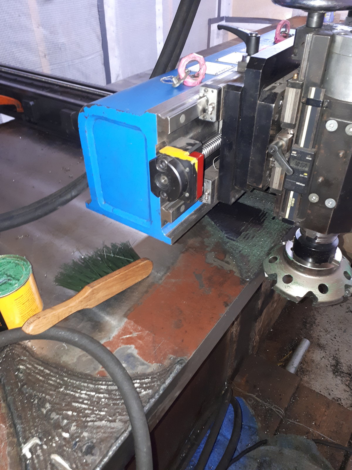

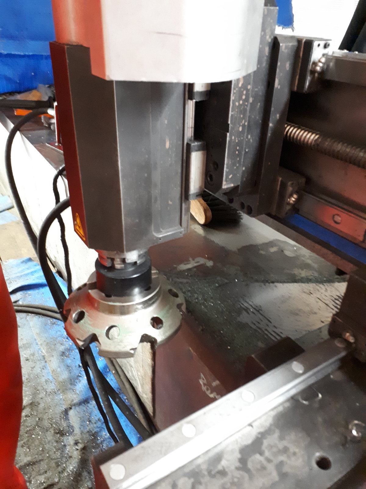

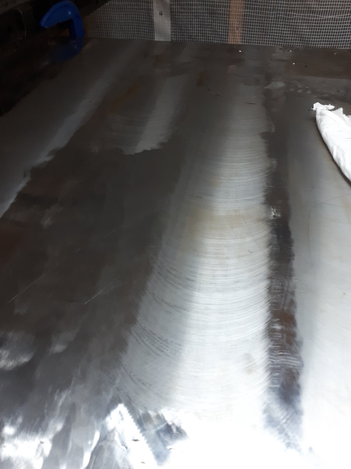

was lookin at a portable milling set up milling an overlay of filarc 88s last night its a,derrick skidding beam 60mm thick plate. there had been a lot of low areas to be built up then machined down with a large inserted face tool its driven by 2 hydlaulic motors one for the head and the other for the traverse. the weld overlay was resonably soft the guy told me certainly less hard than
the base metal probably due to correct heat treatment
