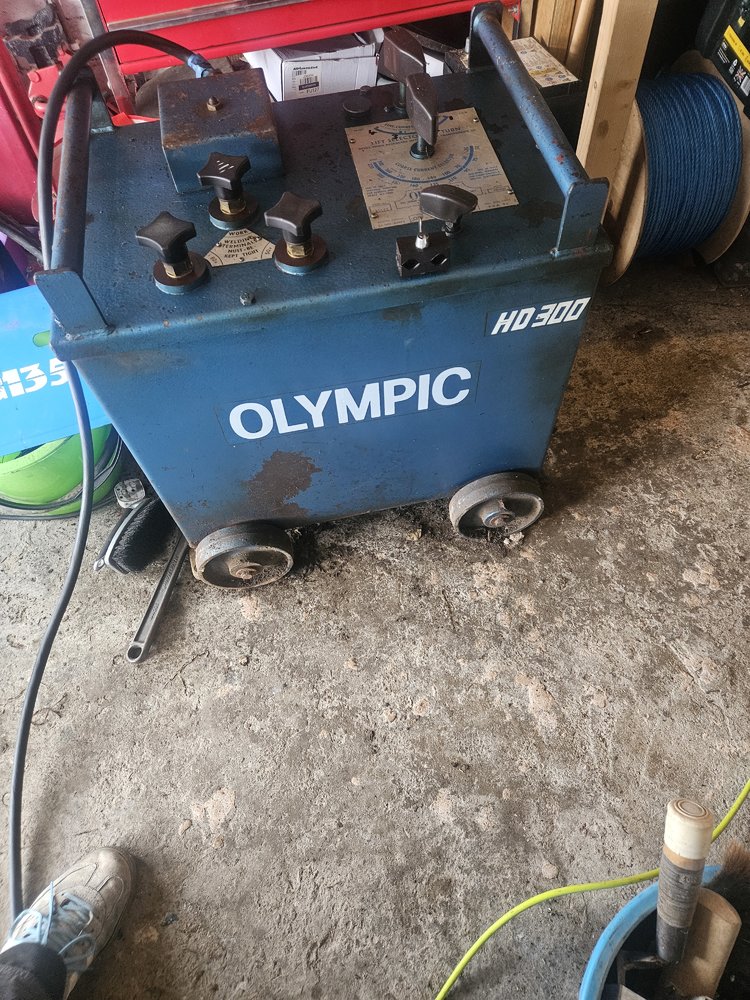

Hi all.
Picked this up yesterday cheap (free), cant find alot of info out there as far as specific to the hd300. So any help/ advice general opinions much apreciated. Also there is no plug on this can it be run off a 32amp 240v supply?. Cheers Dan.
55V × 300A = 16500Wthere is no plug on this can it be run off a 32amp 240v supply?.

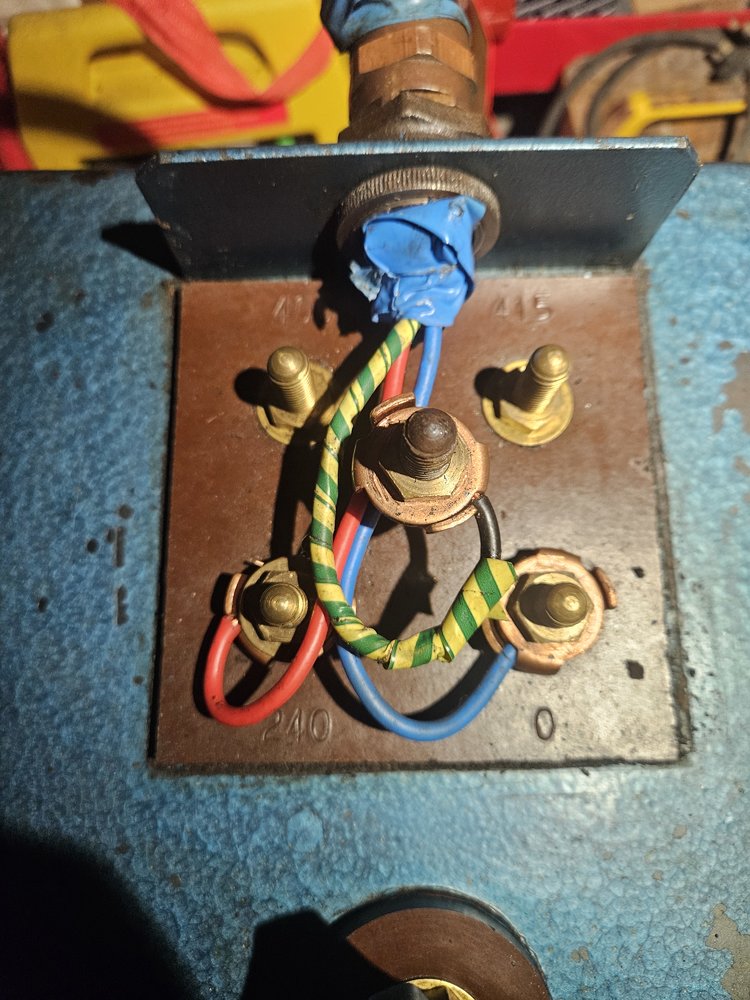

Thankyou very much, very interesting this is what i have inside cover 4 posts.. 0, 240, 400 and 415 and an earth. So would i right in thinking that if i can get a 125a 240v supply to the garage this would be ok? Thanks again55V × 300A = 16500W
16500W ÷ 240V = 68.75A
So if it is capable of single phase operation you would technically need a 125A plug, and might "get away with" a 63A...
But you many not even have a big enough cut-out fuse at your incomer to run that at full power as single phase, let alone worry about a plug.
With that kind of power demand it's very likely that it needs 415V (either split phase or three-phase), if that is the case, when you try to run it on 240V it will give a very low OCV which makes it near impossible to strike an arc.
If you open the top cover where the power lead goes in, and it has 4 terminals (Earth, L1/U/R, N, L2/V/S) then it's probably capable of running on either 240V or 415V, if it only has 3 terminals (Earth, L1/U/R, L2/V/S) it is probably 415V only.

Thankyou very much, very interesting this is what i have inside cover 4 posts.. 0, 240, 400 and 415 and an earth. So would i right in thinking that if i can get a 125a 240v supply to the garage this would be ok? Thanks againView attachment 475551

Those old oil cooled sets are my absolute favourite stick welder's they run so smooth. I've got a 250amp cytringan.View attachment 475522

you will get away with a 32 amp supply on 240 volt easily up to 180 amp weld current continuous. a 4.0mm cable will take 32 amp supply a 6/0mm even better in case of a long lead giving voltage drop . wire for single phase 0 neutral and 240 for the live . if its fed from a breaker it will need a 32 amp c type .domestic is generaly a b type and probably trip just on plugging it inThankyou very much, very interesting this is what i have inside cover 4 posts.. 0, 240, 400 and 415 and an earth. So would i right in thinking that if i can get a 125a 240v supply to the garage this would be ok? Thanks againView attachment 475551
