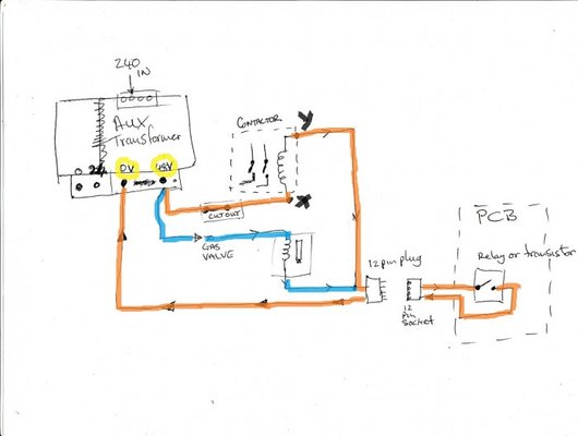

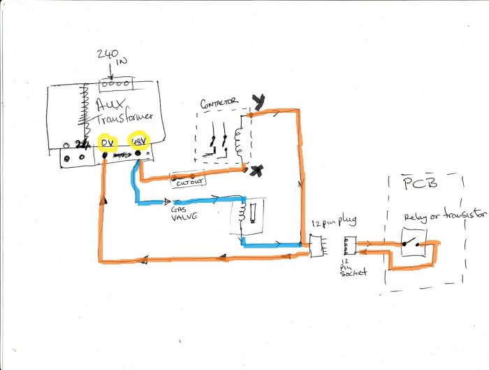

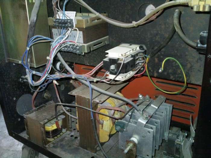

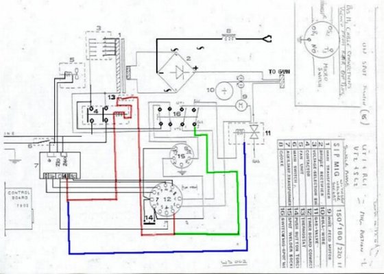

hi chaps hope you can help me the contactor has stopped contacting but everything else working fine i replaced it but just the same ,checking and following wires it seems to work from the same section of the circuit as the gas switch which is working fine i just cannot work out how one half ie gas swich works and other half wont ,cheers for any help, ian i looked through old forums and mine is the one with a 12 pin plug and the the contactor and gas swich are on 48 volt side
i thought i would write in full so you could see what i got up to had me propper dun in thanks for your help and diagrams and no i do not have anything to do with them i live in newcastle they are in york i am just a pleased customer though i will say they have a fantastic supply of bits for old welders if you are looking for parts and they make there own pcbs for older welders i know this because i thought that was the next thing i would have to buy( bloody contactor )cheers i hope some of my research will be of use to your members
