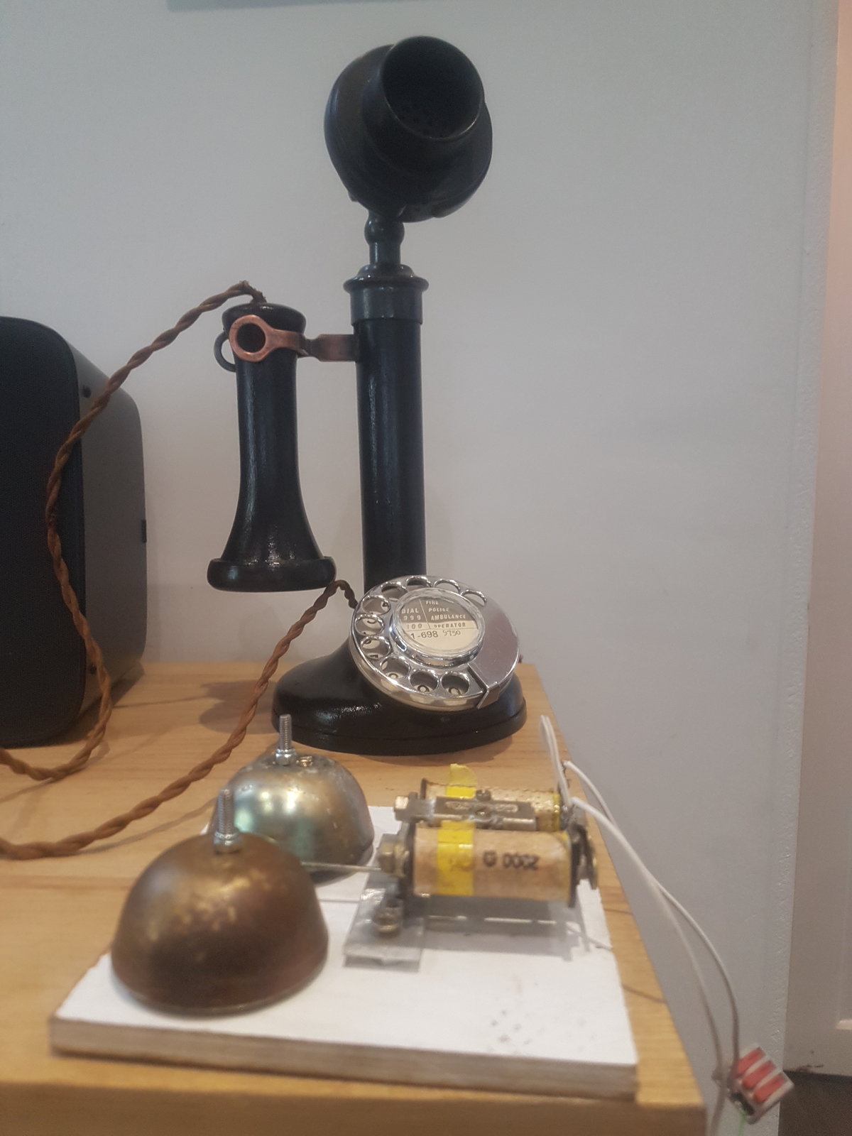

Yes it is handled by the exchange. Ring voltage is superimposed on the line and being AC is not blocked by the ring capacitor, therefore allowing it to power the bell. When you lift the handset, it changes the impedance seen by the exchange and so turns off the ring signal.wow how does it know?
does that happen at the exchange
