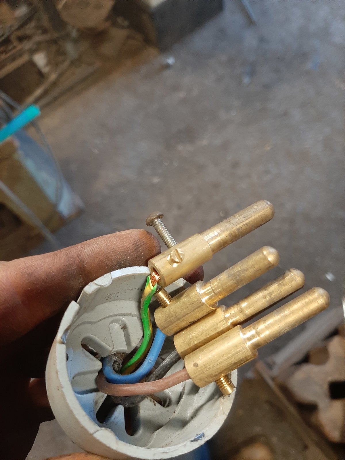

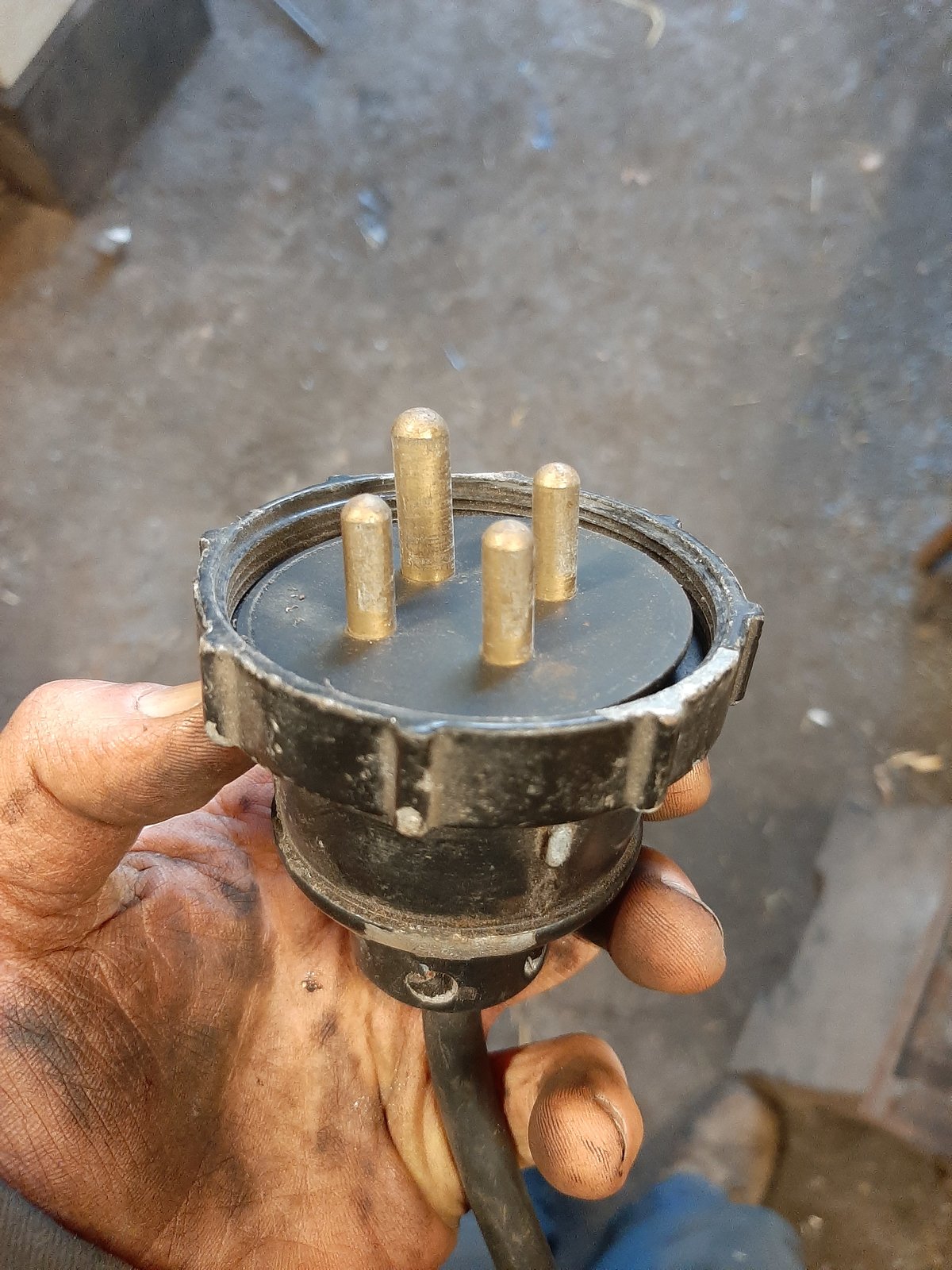

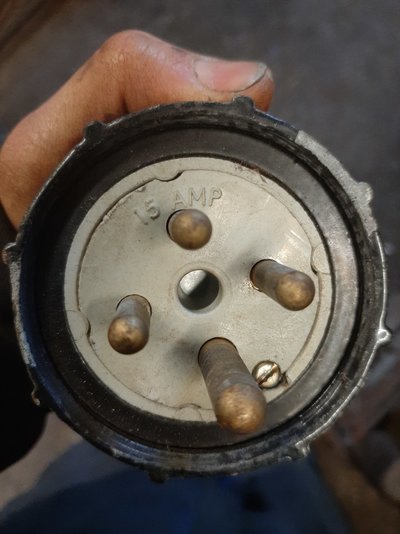

Surprised your 4-core has 2 lives and a neutral though, all the 4-core I've bought has earth plus Brown-Black-Grey... There isn't a grey in the cable trimmed back under the sheath is there?
Dave H. (the other one)
So to confirm, I should wire the extension cable as Helpful Dave says & change the wiring in the saw plug? (4 core wire into a 5 pin plug)
There is no grey in the 4 core wire coming off the saw. Only Earth, Brown, Blue & Black. I have left the Neutral empty. It does seem to run ok...?
