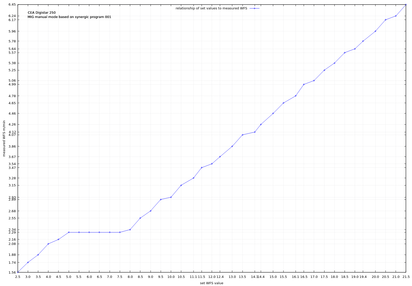

I discovered that the wire speed numbers on display do not correspond to meters/minute. For synergic program 001 the lowest speed is 2.5 and highest 21.5, in reality 2.5 on display is ~1.6 m/min, 5.0 on display ~2.3 m/min and 10 ~2.9 m/min. Checked with straight torch cable, no tip and no reel brake. Also averaged over four 4 second runs, because the wire feed stops automatically after 4 secs when no arcing.

Once I discovered the nonlinear discrepancy between displayed numbers and real WFS I had some success. With WFS ~2.8 m/min it welds, but blows through 0.8 mm sheet in no time. Arc is fierce as if voltage is high and fiddling with voltage does not help. I will talk with local reseller but they are clueless. When asked how to set wire speed below 2.5 m/min, because 1 m/min is written in tech specs they mumbled something about submenus and getting soon back to me. When they got back they did not have any answers, only more mumbling.
