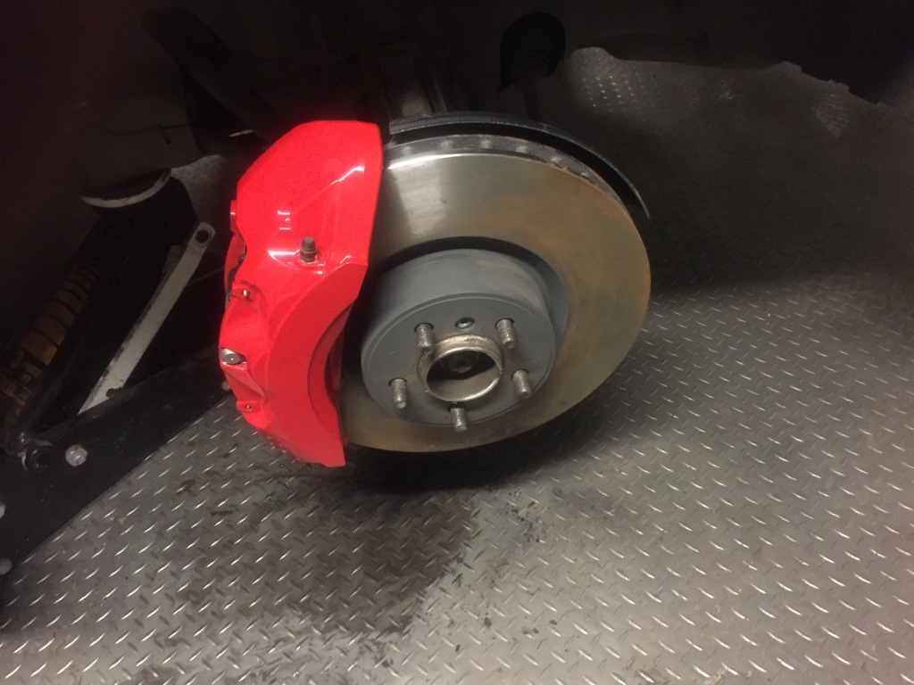

Gorgeous. Is 2K brake fluid resistant? Guess what... the Halfords caliper paint was not !!I just bead-blasted then sprayed 2k topcoat direct on my calipers when I did them last year.
Seems to be lasting very well so far.

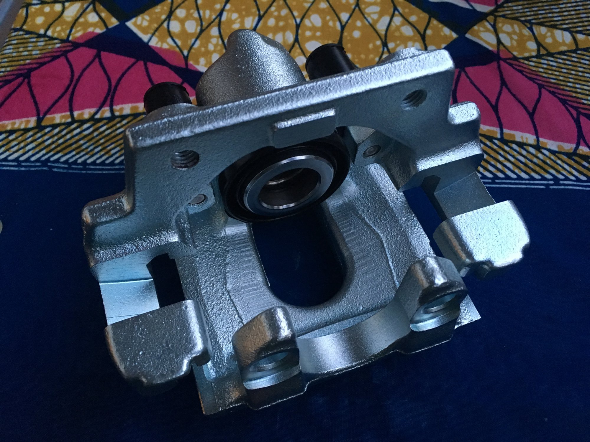

Just overhauled my rear brake calipers. These are ATE calipers originally zinc plated, so I went with the same finish. There was no problem with the cylinder bore, zinc will even protect it. I went with 10μm thickness for safety.
