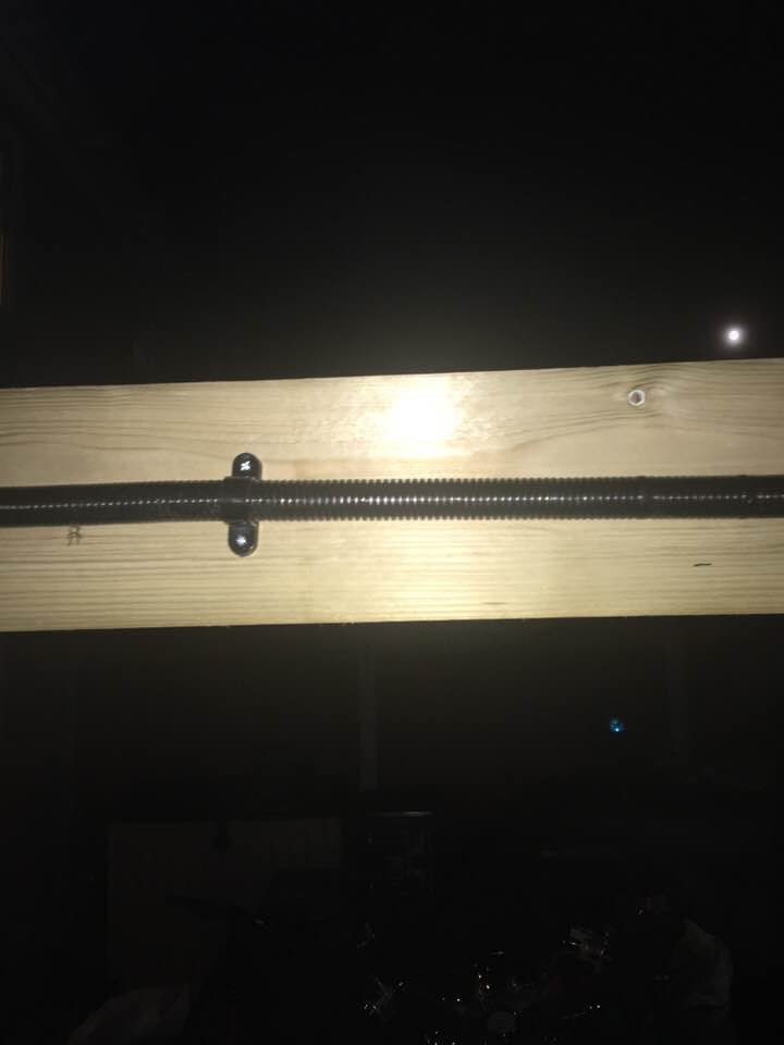

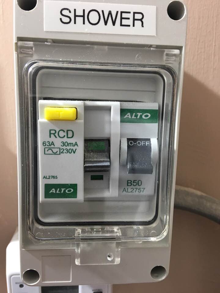

This is going spare in the cupboard under the stairs as the shower has now gone. So I'm running 10mm twin and earth from this overground through flexible conduit to the workshop.

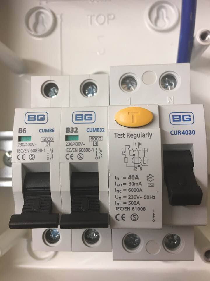

I am putting in a consumer unit in the workshop which contains the following.
I'm thinking I need another 32A MCB for the 32A socket to run my Portamig on which will mean I will then need to swap out the RCD for an 80A. Is that right?
Any obvious major issues with what I am doing? Will I die or burn the street down?
