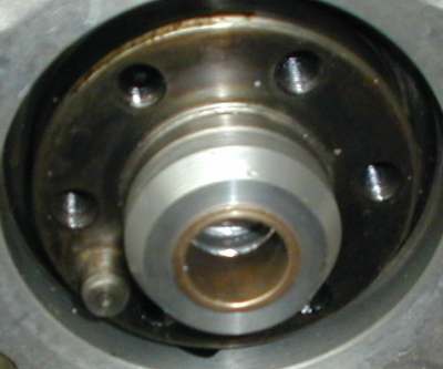

Its how they were all done.... never seen one fail before the clutch needed replacingHi, Considering the differences of surface finishes of the crankshaft bore and the gearbox shaft the bush needs to be stationary in the crankshaft. A comparatively rougher finished machining in the crankshaft as opposed to the ground and hardened surface on the gearbox shaft, I can't see it lasting long.
