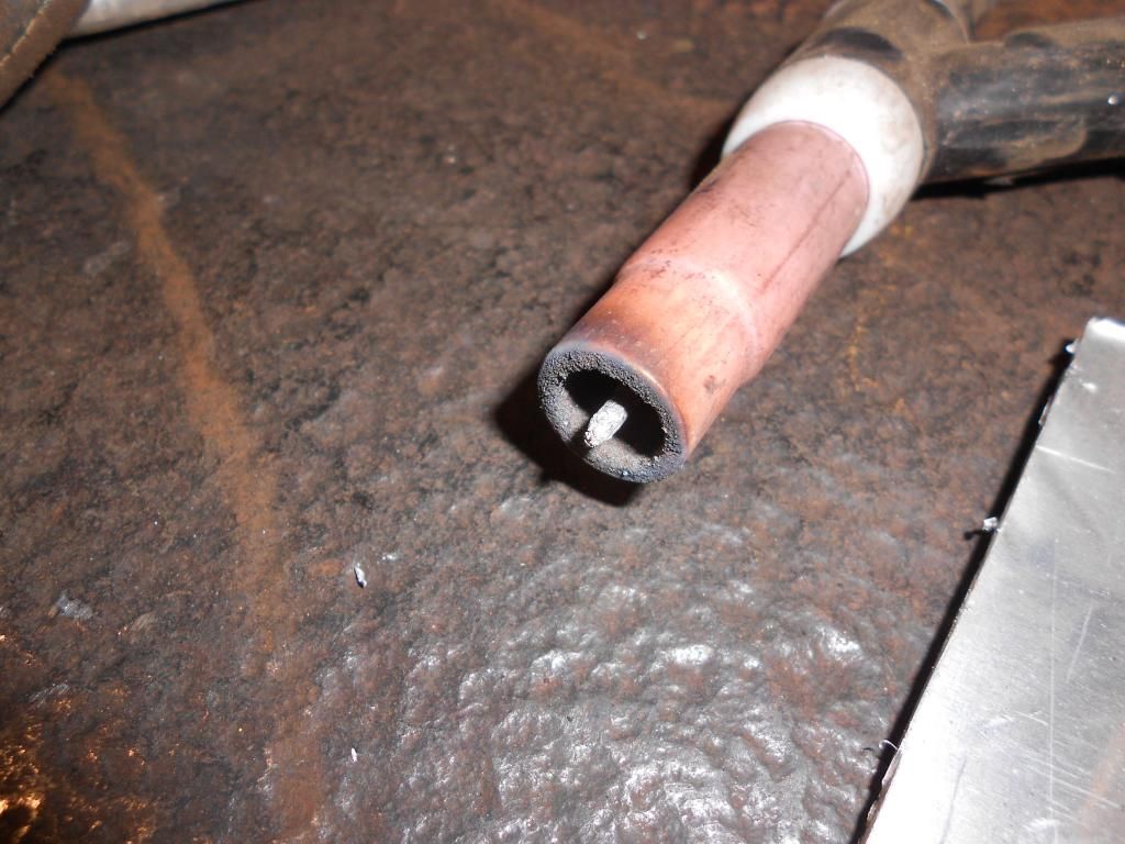

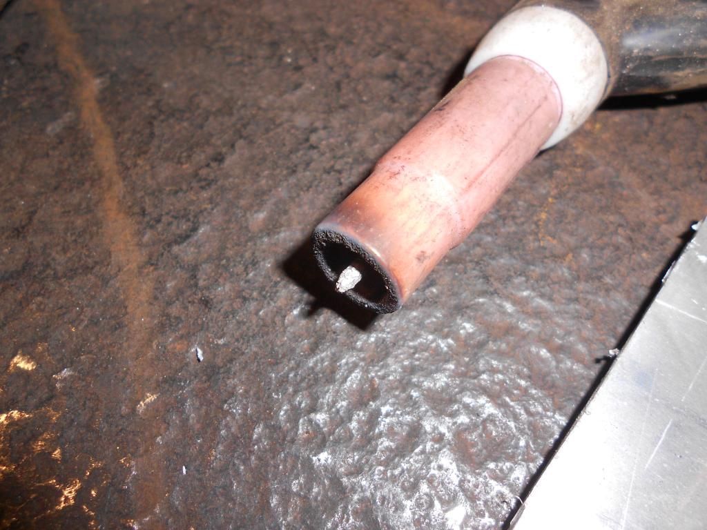

If you're successfully welding with your DC I see no reason why you can't weld with that. I am just starting myself and I've managed to pick up both in a week. Not to any standard of course but improving all the time. I use a 5,6 or 7 ceramic and 2.4mm white electrode poking out about 6-8mm and ground to a very shallow point.
