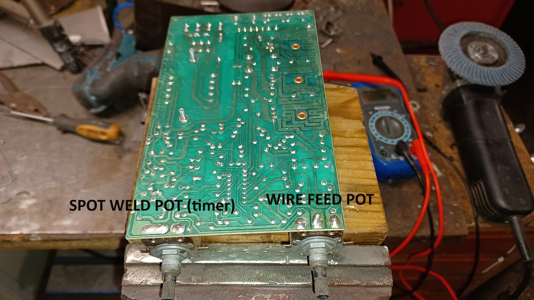

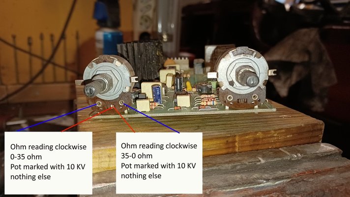

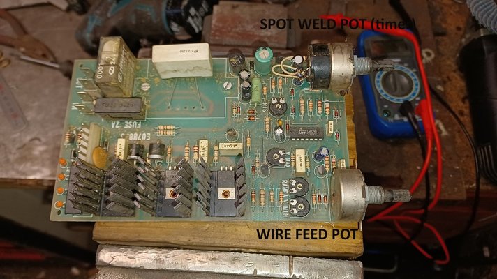

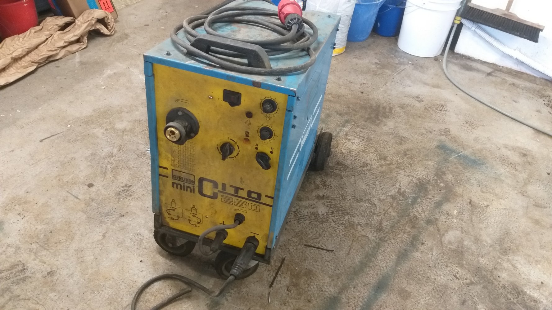

Sorry to post here but I couldn't find a category for my mig welder, so I have a Oerlikon Mini Cito 250 mig welder that I got for free (it's an old one). It was in a garage fire but made it out in time, needed new hose and ground cable. I been welding with it for a while now and it's working just fine except for one thing, the wire feed is to fast.
Even if I turn it down to 0 it still moves to fast for welding on power 1, so I'm wondering if it's just the potentiometer or if it could be something else??
Cheers from Sweden//
