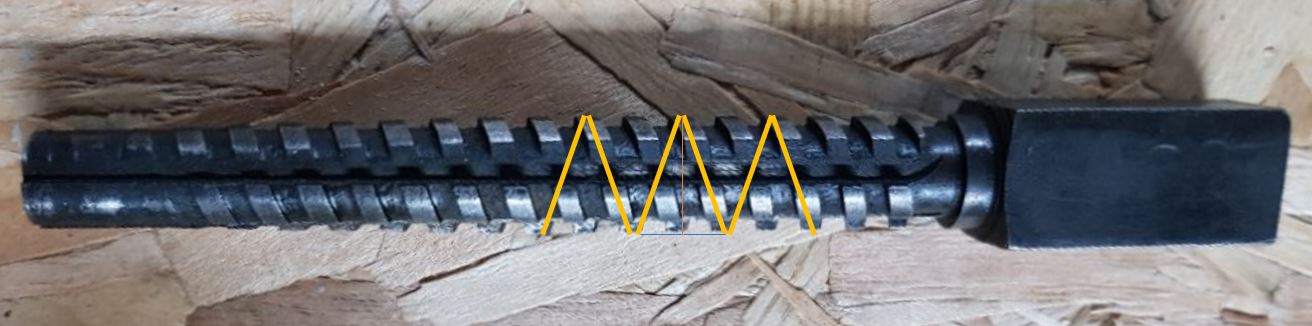

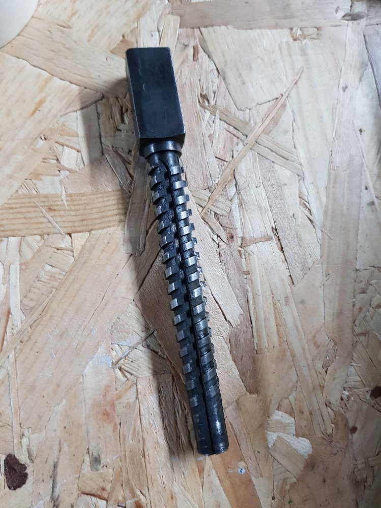

Unfortunately no markings at all on it , i suspect its quite oldI have a couple of trapezoidal for making my lathe nuts, does it say the size?
The thread is 90 degrees though so like @Seadog says square thread most probably , what use it is to me i dont know but could be the same thread as some vices use maybe ? I hate chucking anything but may never use this. I will try to get a measurement off it later but to me looks like a very coarse thread to fast for a vice thinking about it nowMy first guess would be an ACME tap too - but strange no markings on it.
maybe i'll check it laterAre you sure it's single start? Looks like it might be twin start from the helix angle
