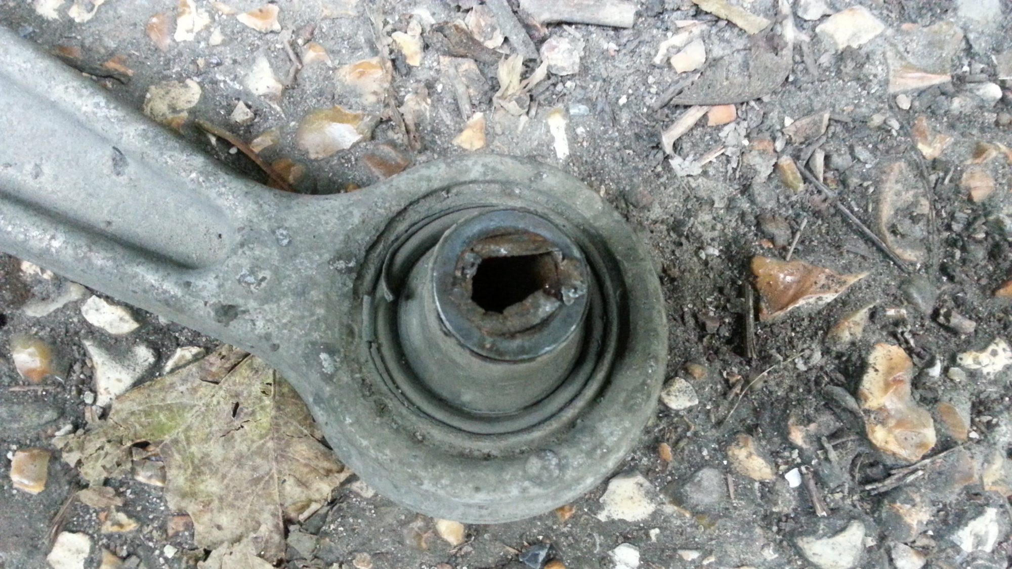

Replacing a front suspension arm bush in my SAAB 9-3 (2002 model so early GM).
This one
No. 17 on this drawing https://www.esaabparts.com/viewparts.php?searchpart=1§ion=474055225
Got the correct replacement rubber/metal bush and will shortly have the thin inserts to go with it (no.19 on the link above). However the (almost fully threaded!) bolt that goes through is is 12mm dia, the bush hole is 16mm - no way are the inserts more than 0.5-1 mm thick meaning that the whole thing is going to have 3-4mm of slop. - Which would explain the mangled state of the original
What am I missing?
