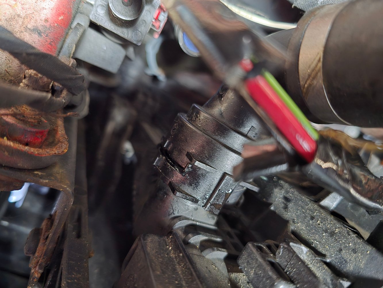

I'd appreciate suggestions of what to do with this - it's leaking (only slightly now) from the bottom hose connection to the radiator. It's one of those attachments with a spring circlip type thing and there is a O ring inside the coupler on the hose end. The original O ring was flattened off on the inside, so I bought some Nitrile replacements - 40mm OD by 4mm cross section. The O ring swap certainly seems to have reduced the leak but not stopped it altogether - maybe the original O ring is non-standard but it's very close to the replacements I bought. I could replace the hose but there seem to be dozens of different types - even when I specify in my reg. If I could find some suitable generic hose (32mm or thereabouts) I could jubilee clip that to the rad and make an adapter to the original hose with a couple more jubilee clips. I would need to work in a 90 degree elbow somewhere.
Any ideas please folks?
