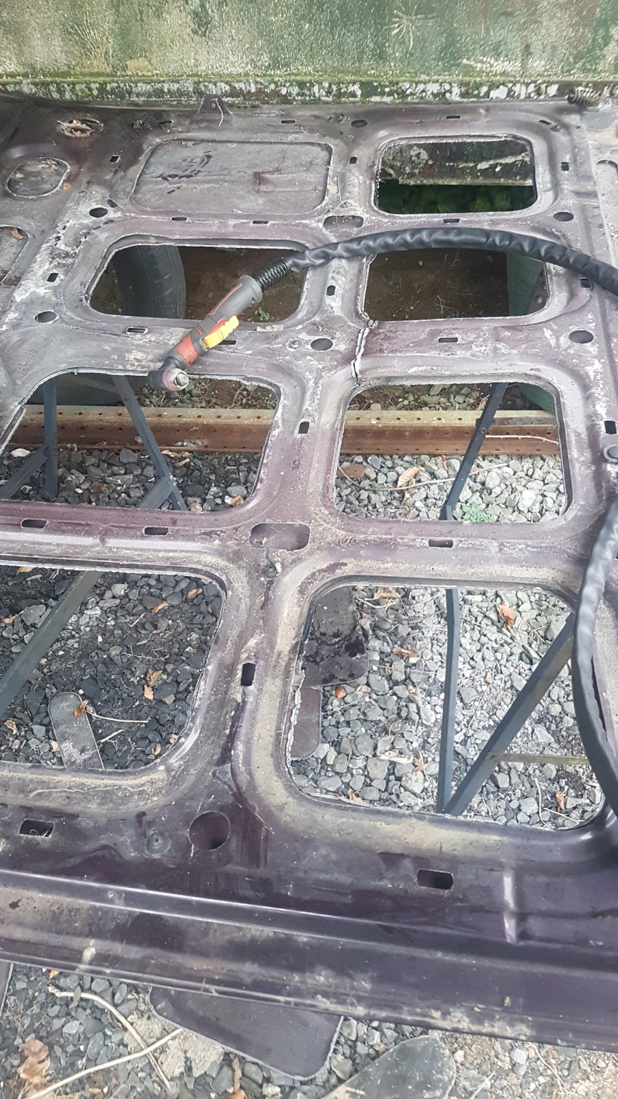

I would like the plasma cutter mainly for gouging and demolition ,because often i need to do this

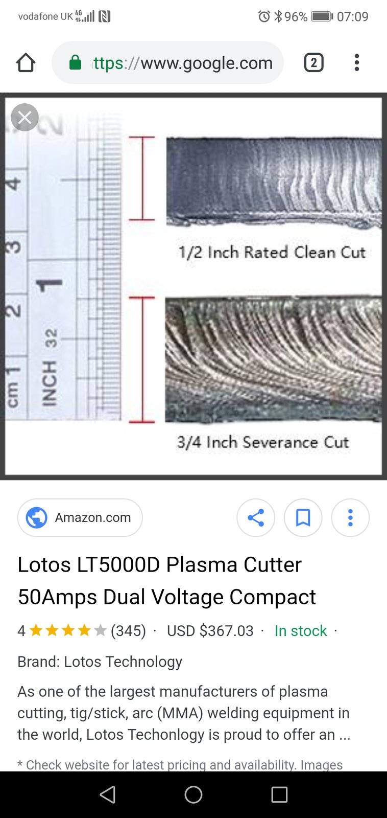

. One thing you will find, depending on the plasma that you buy, consumables will last a period of time. If you haven't had or used anything else it will be no difference to you, however get a top name manufacturer and the consumable life is massively different. I have plasmas that are near 20years old, they work and work well, but the tips and electrodes don't last anywhere near what Hypetherm consumables last. I would say Hypetherm parts last 10 times what others last, but that is also dependent on other factors, operator, air quality. So good luck in your venture
