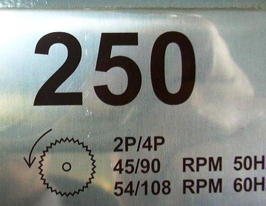

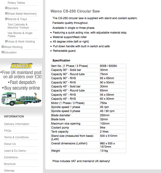

O grand wizard of the ancient black art of elektrickery please reveal to me the secret of: the 2P/4P on the plate of this single phase saw.
Normally indicates 2 pole or 4 pole motor, though I always thought 4 pole was 1/2 the speed of a 2 pole but this seems to indicate the other way round if the 2p relates to 45 and 4p relates to 90??
Maybe I'm reading it wrong though.
No, t'other way roundIt's the other way around, is it not; The more poles, the higher the speed?
What's unusual, my poor punctuation, what does :, mean?Unusual lol![]()
