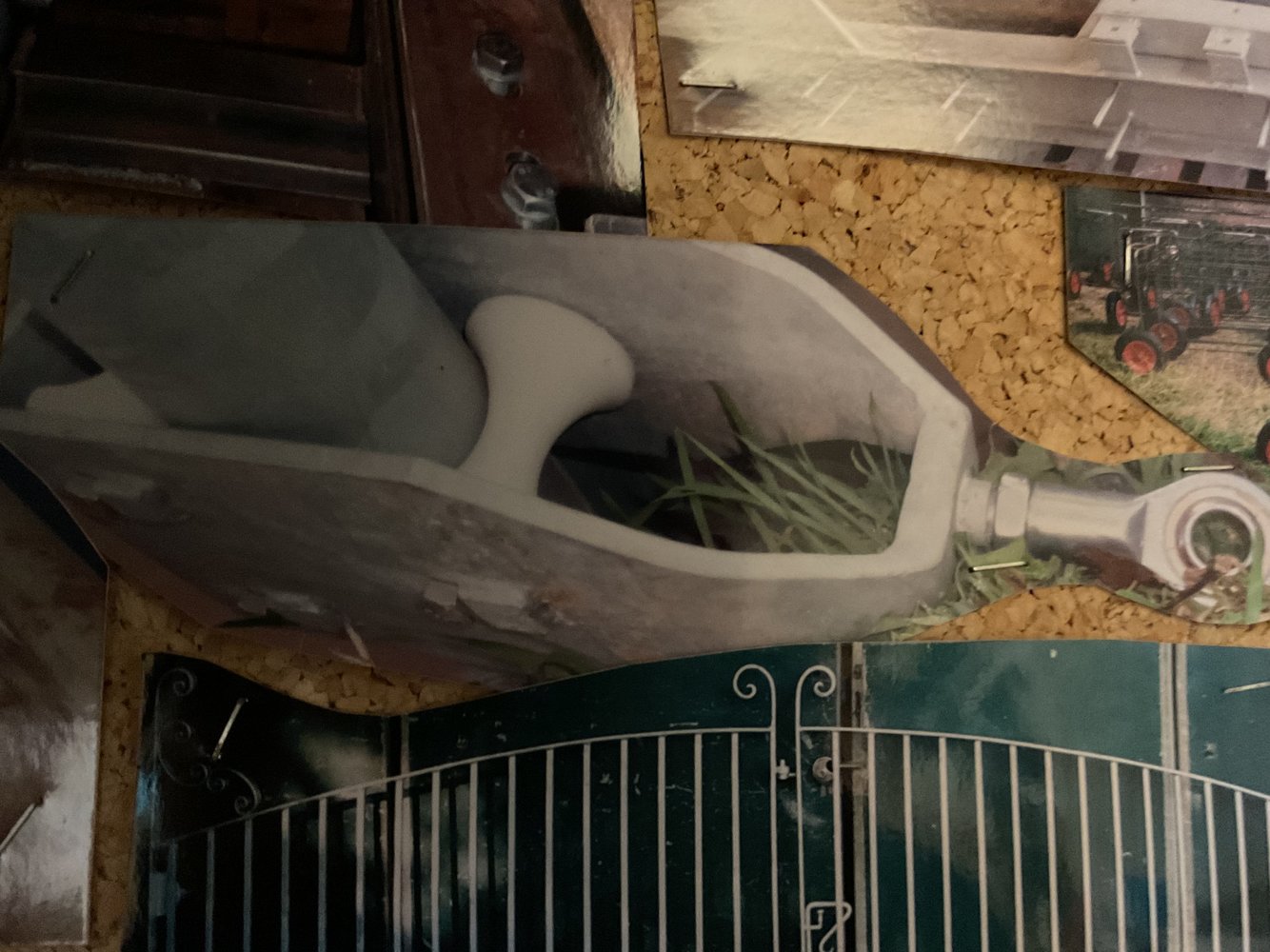

I've not yet decided on which material yet, but the sizes I'll need (at the moment) are 8 blocks of 16 x 50 x 150.Used to use black nylatron in just that sort of application - blocks with a slot cut into them to use as a guides, wrapped around 50x50x5 RSA. And as solid blocks secured to run against hollow sections.

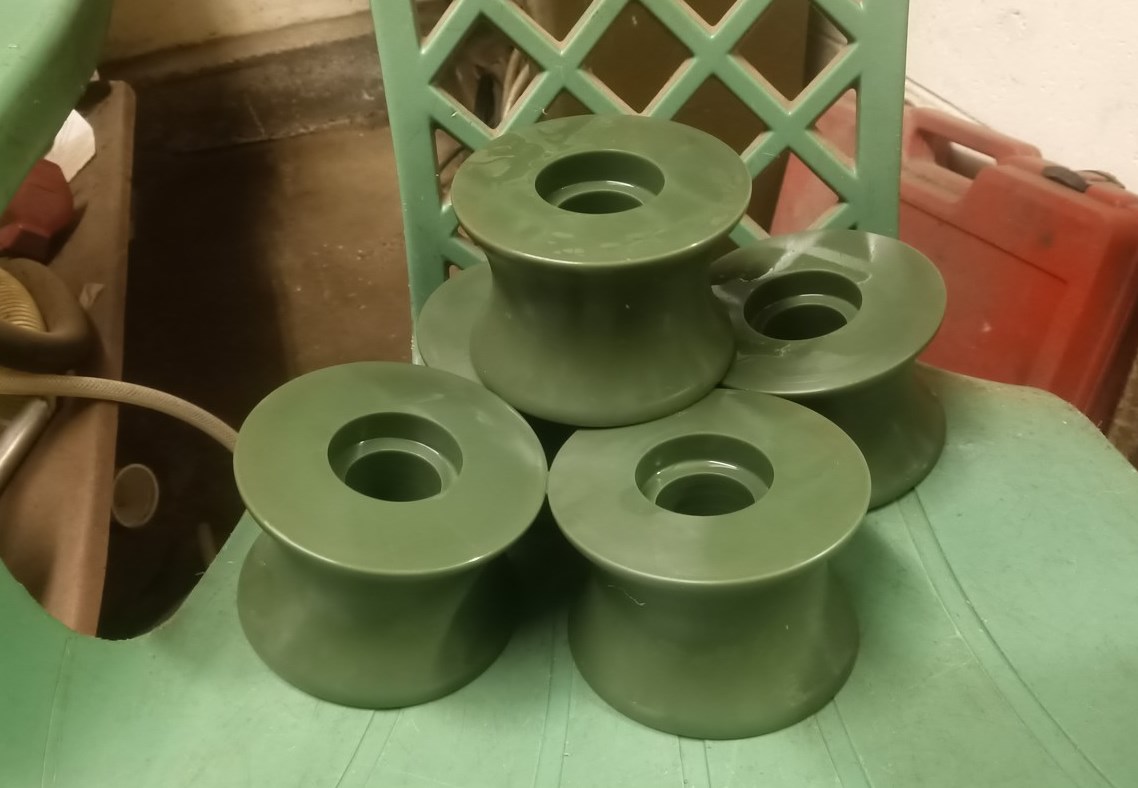

If you like the sound of oilon - I may have some going spare if you're not after massively thick or large pieces.
