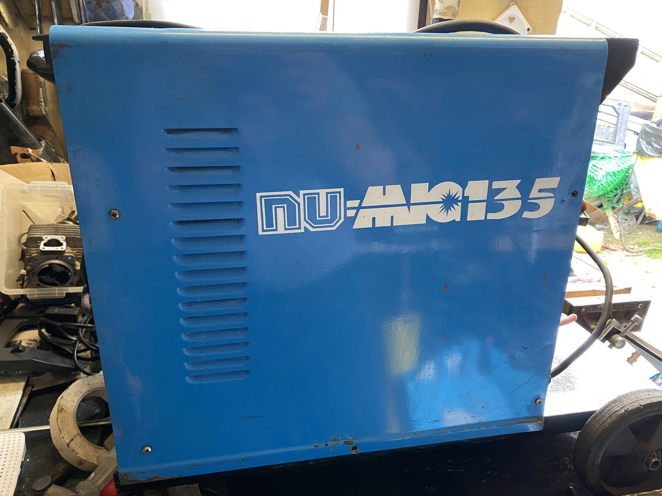

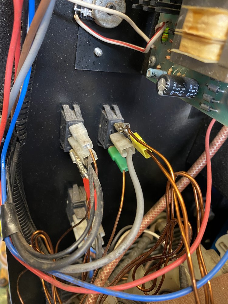

I probably have one that I can rob off something else. It’s just a 3 pole rocker. All that work just for me to cock it up at the last hurdlethe rocker switch? if so, easy enough to find RS, or Farnell.... there a pretty standard size..
I found a 3 pole 2 position on / on toggle switch in my box of rare collectible treasure in the shed. I have fitted that temporarily until I can get some new replacements, thank you for your kind offer.I will post you one rocker switch FOC, by way of reward.
I'm happy to stand anyone a stamp.I found a 3 pole 2 position on / on toggle switch in my box of rare collectible treasure in the shed. I have fitted that temporarily until I can get some new replacements, thank you for your kind offer.

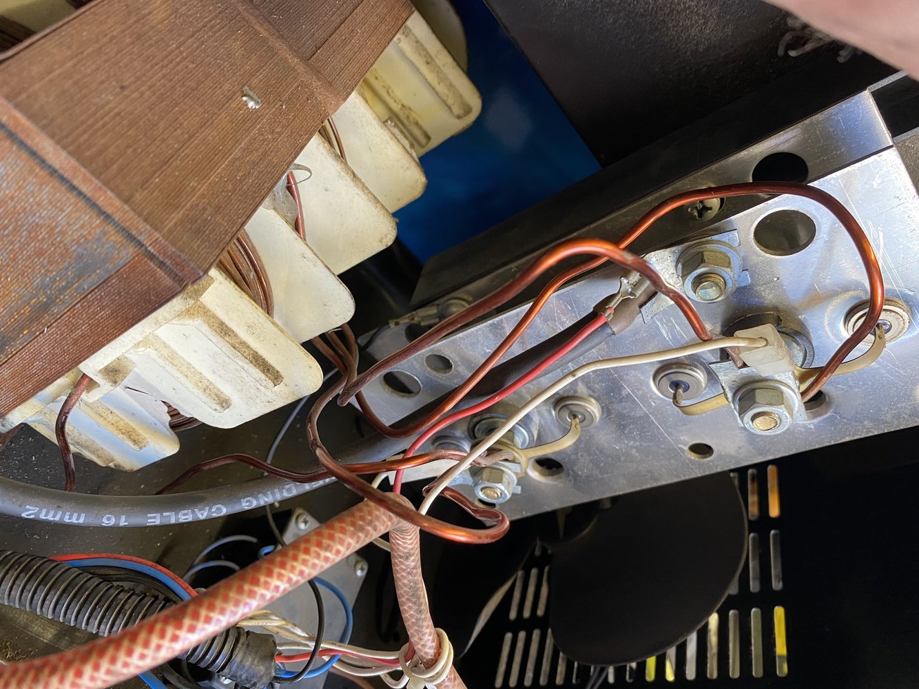

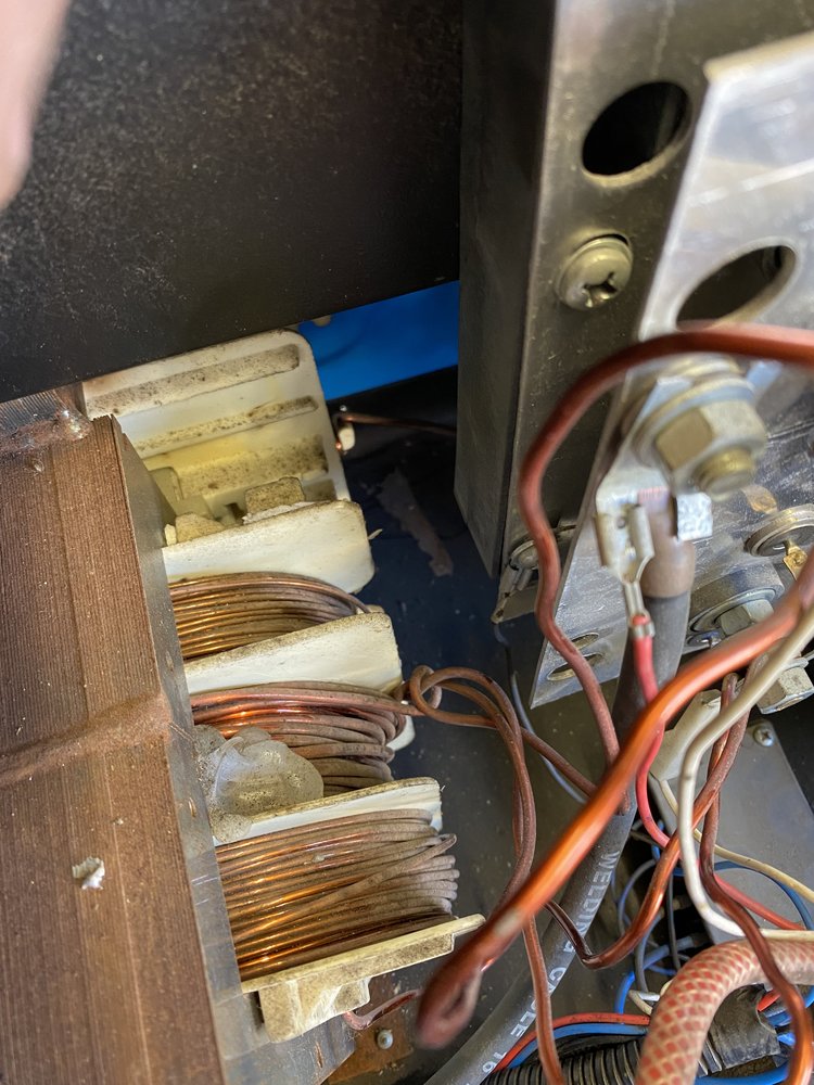

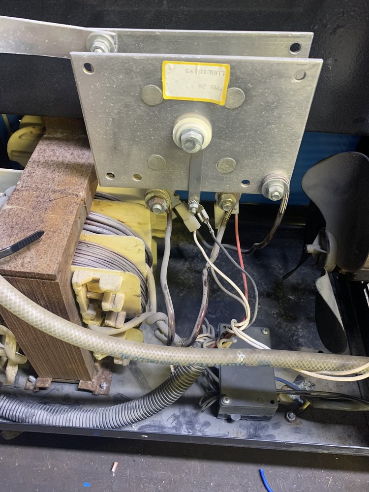

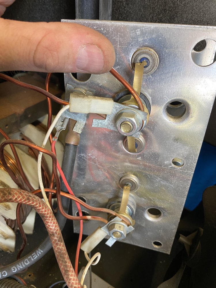

ok, that went well. A0-B1 = 63v
A0 - A1
1-3 30.3v
1-4 37.7v
2-3 26.9v
2-4 32.7v
B0 - B1
1-3 30.3v
1-4 38.6v
2-3 27.4v
2-4 33.1v
These numbers seem wrong? Shouldn't they be ascending as the powe switches up?

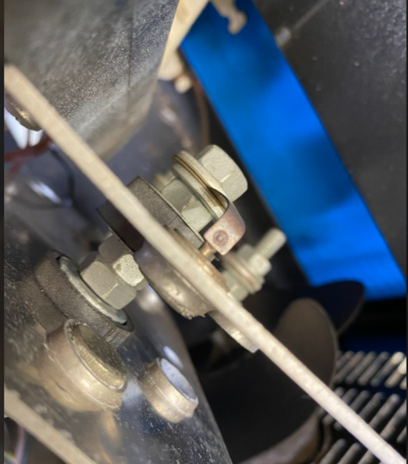

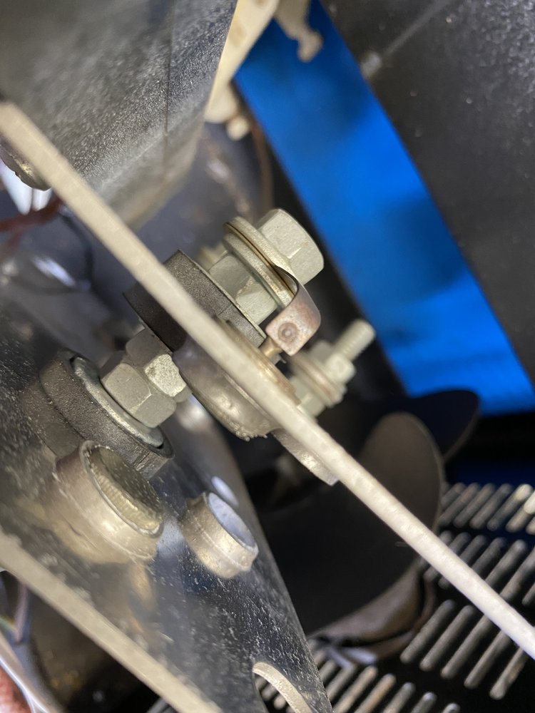

No, it was the bottom terminal of switch 2 that snapped!If this is the switch that you snapped the terminal off, perhaps it was [choose your deity]'s way of telling you it was wrong
Well to do an easy summary of what was bodged..What would be useful to finish off this complex thread is a summary of what was bodged, if you've worked that out with unusual the dual transformer construction.
