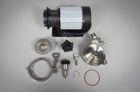

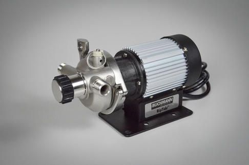

I made a nano brewery a few years ago, about 20 gallon a brew. After years of sodding around with a variety of "beer" pumps and solar pumps that have sub-optimal priming and speed/flow control, I have splashed out on some decent Blichman pumps. I did hang out as I was going to make some monster peristaltic pumps out of some old brake drums but realistically with work, kids, DIY and the queue of other stuff it wasn't going to happen any time soon and a pump dying half way through a brew yesterday was the final straw.
So at great expense, I bought two of these Blichmann riptide pumps. Handles boiling liquids, built in vent and flow control and easy to take apart to clean, a brewers dream
