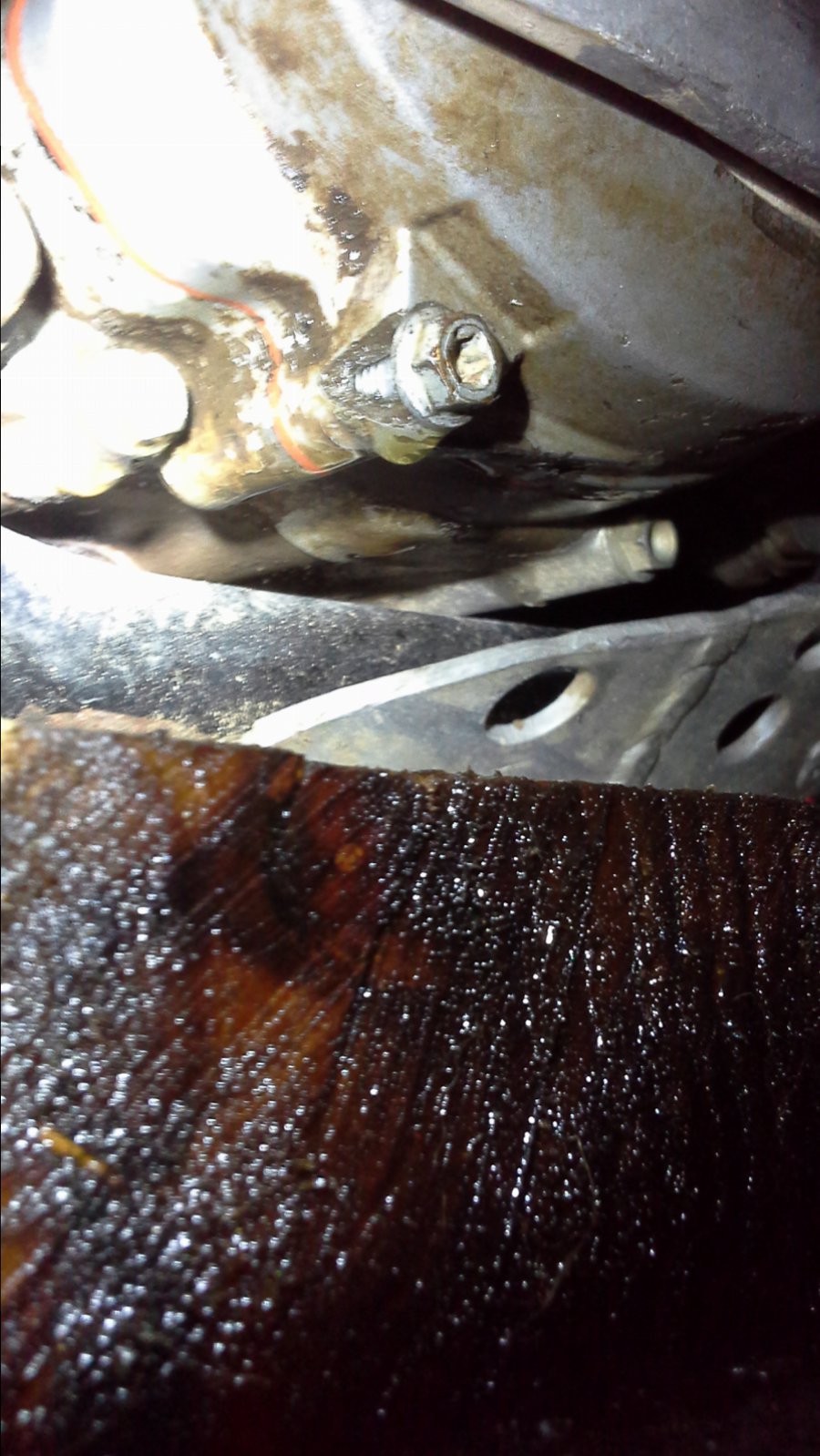

Something like jbweld would do for now, coat bolt in vaseline torque it up then put jbweld on the casting (after a good clean up)and it should set to pattern of thread without sticking so you can still undo the bolt afterwards.
Or maybe just stick some ptfe tape on the threads, will probably stop the leak as it not under pressure, looks from the pic as thought oil is probably leaking along the threads.
