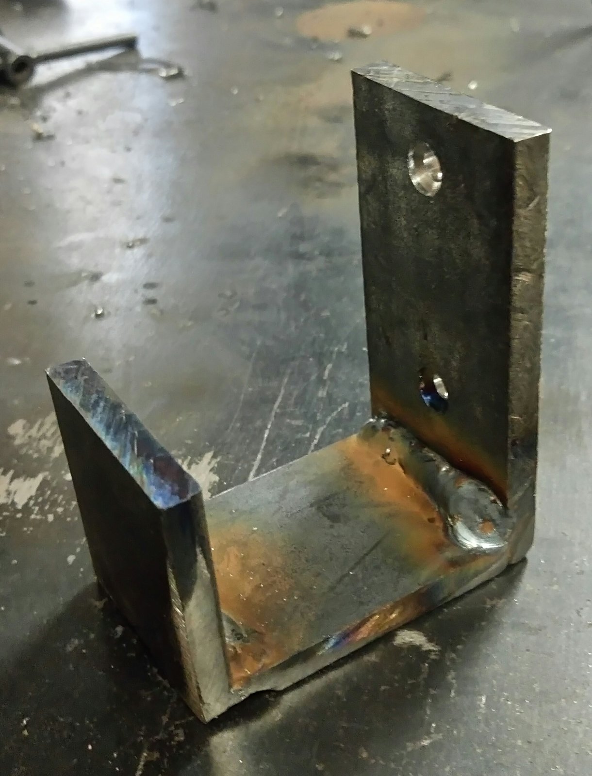

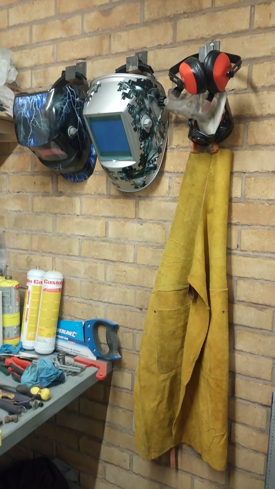

Made some simple hooks to store Helmets & PPE easily!
They are certainly not going to snap under the weight.
When you make anything like that, to give it a slightly better appearance and safer to catch the wrist on do a small 45 degree cut on the corners and just round off the edges a tad with a file.
When I was an apprentice the big boss man always told us 'I will run my hands along everything you ever make and the slightest cut I will beat the life out of you' not really the best of training methods but it worked.![]()

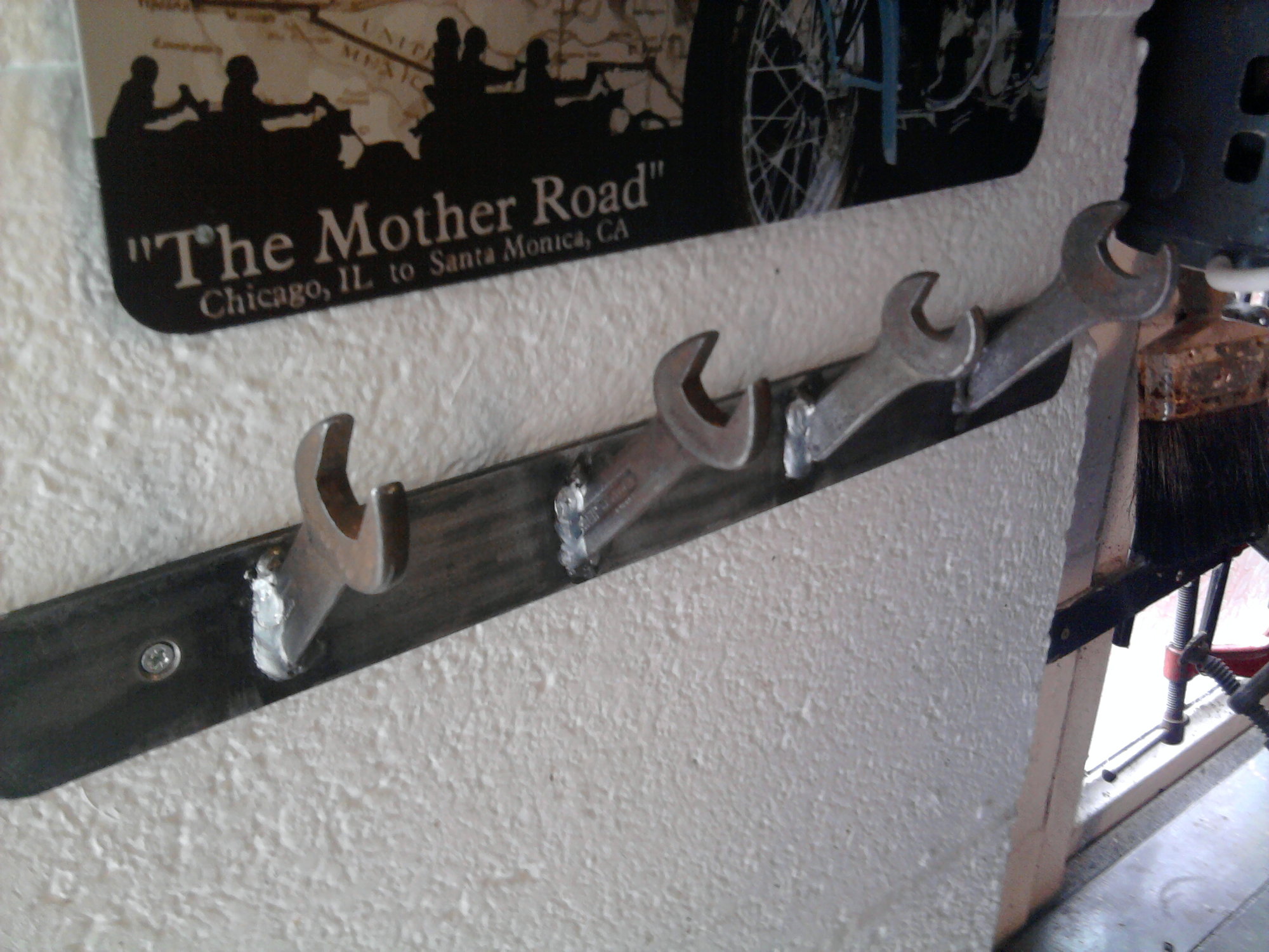

Here is a 'man cave' design for some workshop hooks I made, some car boot spanners for 20p and a bit of scrap flat bar.
View attachment 124235 .
