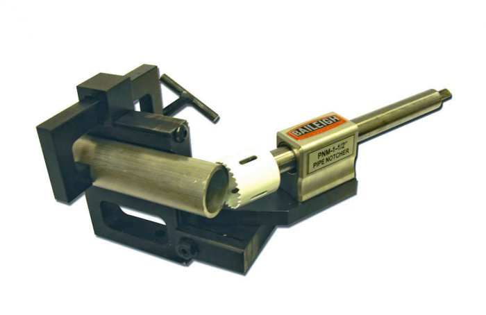

Stil stoopid money as I said just bought a TH76-H from Baileigh for 175quid.
I also use constant pitch holesaws.
I use and sell this one below, Its invaluable when making roll cages & tube chassis's, Had mine for about 15 years and its still cuts perfect, They are £100
Why anyone that notches a lot would cut and file is beyond me as it takes around 30-45 seconds to notch any angle with this.
I use my cordless drill on mine.
What size od tube will this one take Steve...?
Any reason for using these over dual pitch wyn...?
I don't think there is a cut it will not do, up to 3"
had a look around and found thees and this one
but i like this one the best
the website
a lot will depend on the type of work you going if it's just right angles notches then there is nothing as quick as the lever type one
the hole saw type will be slow going through pipe but more versatile for angles
