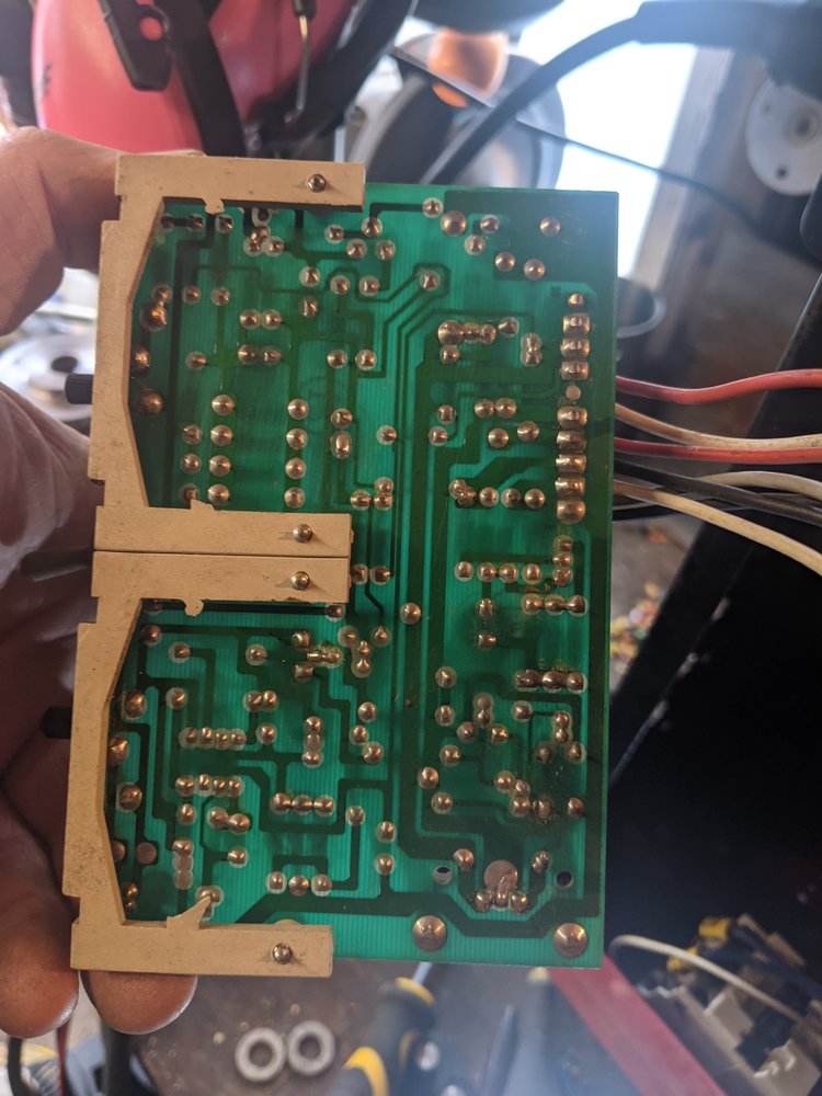

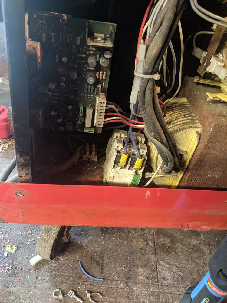

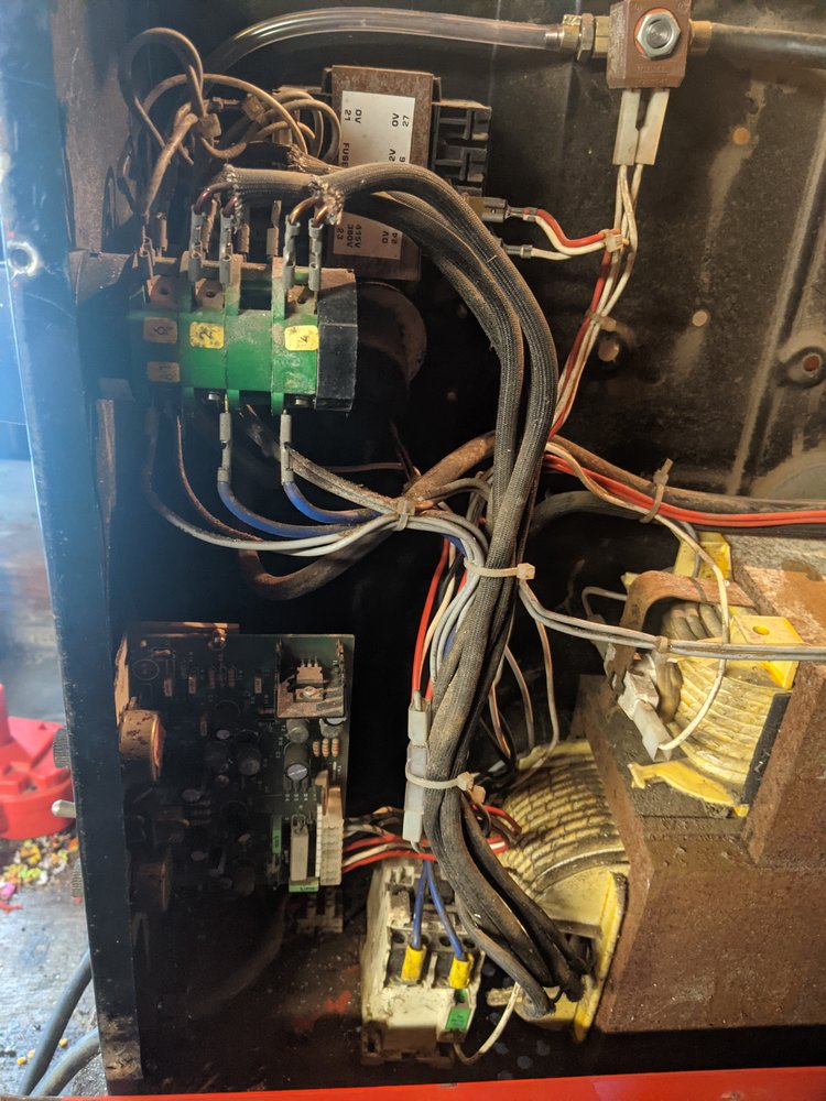

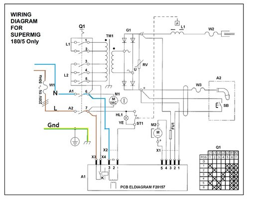

The fan runs so you have AC mains power in the machine. If you turn the power selector switch to one of the low ranges, e.g. 1, 2, or 3, and then operate the contactor ( main relay ) manually with a screwdriver as above, you should be getting mains through the primary of the main welding transformer, and welding power output at the secondary. The wirefeed may not work, but if you hold the torch with the end of the MIG wire touching a piece of scrap in the work return clamp, does it strike an arc?Right had the main in relay all apart and cleaned the contacts all up looks a treat now and freely movers up and down I tried holding down the middle of the rely with a big insulated screw driver and still nothing there just doesn't seem to be any life in the old girl
