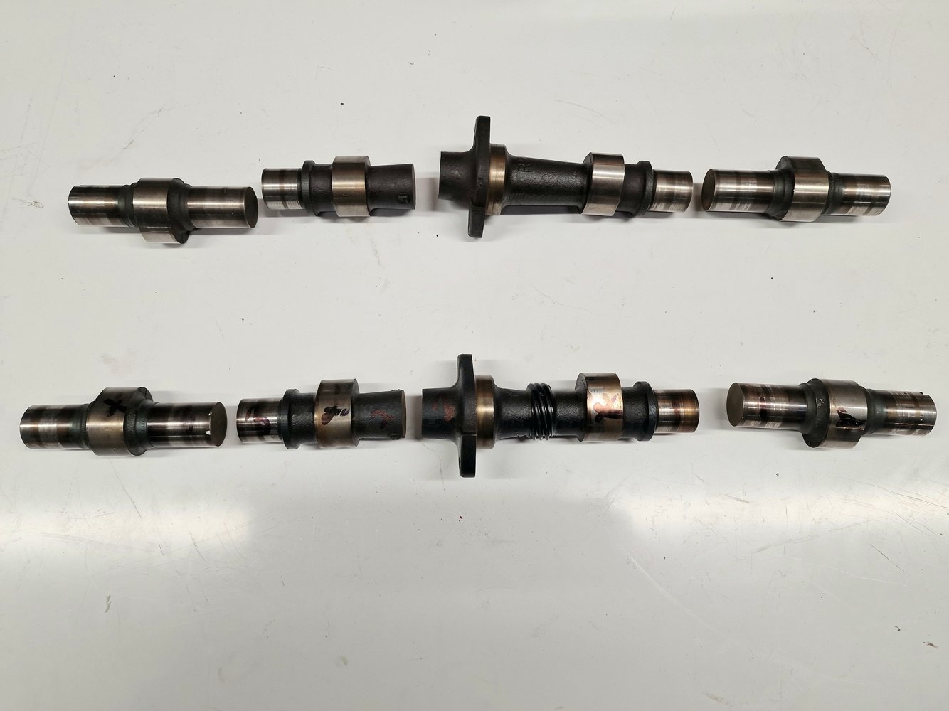

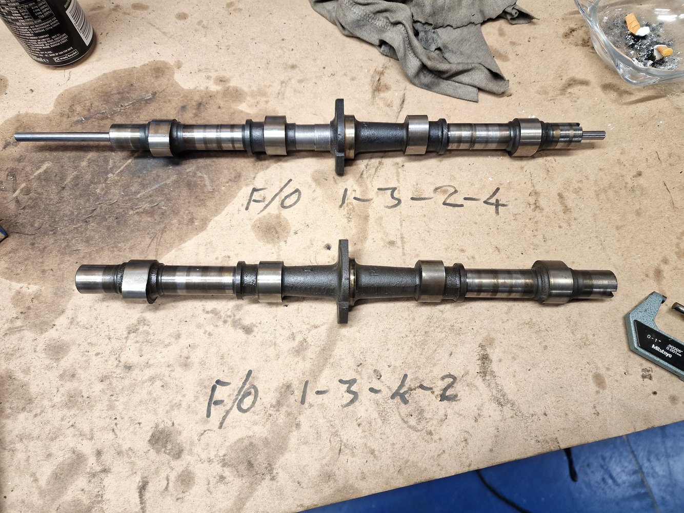

Bit of a "want to have a go" project. I want to convert one of my Yam xj 8valve 4 cylinder engines to big bang - sort of farty twin.

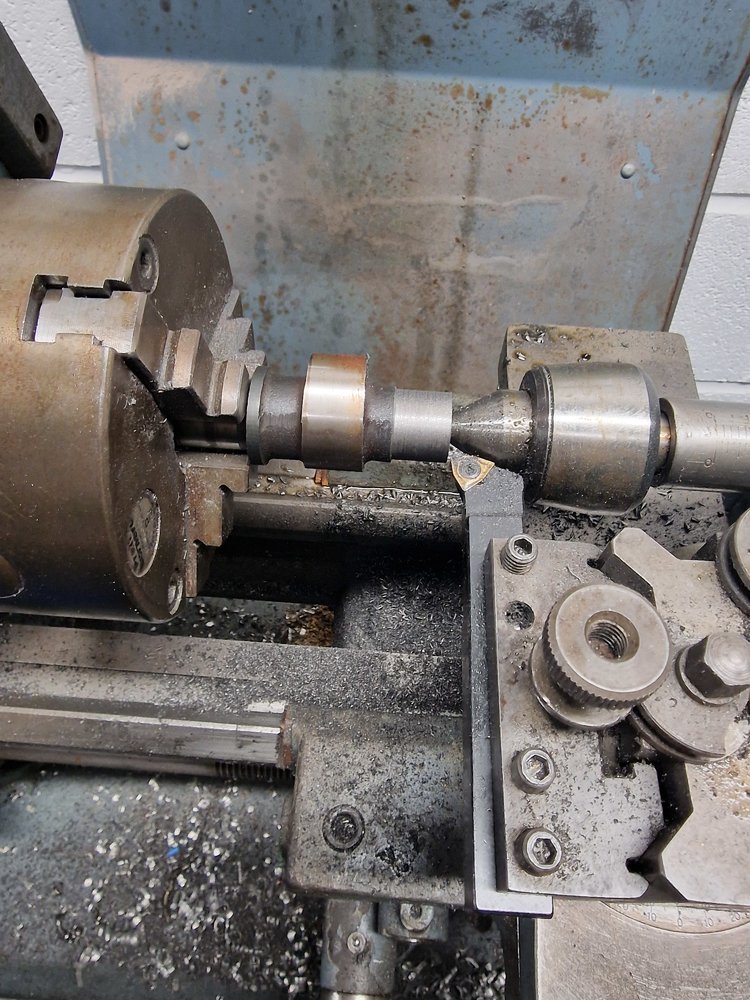

The cams need a cut, rotate and reweld. They emit orange sparks when you grind them so expect they are cast iron of one sort of another. Allen Millyard shows how he did some Kawasaki ones, inserted a sleeve (gudgeon pin) and tigged them together. I don't know what filler he used though?
Now, as usual there will be the Harry Enfield cry of "you don't want to do that", but the only real option is to machine some new cams from billet, and right now that's a project too far. If Millyard can do it??
